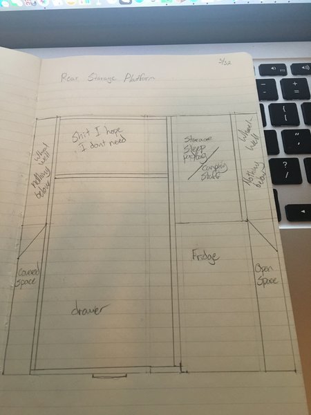

    So I was chatting with @G.T. about a storage/sleeping platform for the rear. I had an idea in my head but I usually put the fridge in the cab with the rear seats removed but when I get to AZ I plan on taking my family out wheeling so I need all my seats. So that threw off my original idea and had to put a little more thought into it.
    The tacoma bed is pretty slick so with some help of some sort of plastic slider on the bottom of the fridge and drawer I should be fine without drawer slides for the time being and save a little money now or maybe ill keep it that way if I like it.
    So the fridge will be enclosed with a storage above it for my stove and some other cooking bits.
    Behind the fridge will be storage for my sleeping pad/bag below the top sheet using a false door for access.
    Above the false door will be my cooler storage or a storage bin depending on how things play out, cooler may ride in cab for the mean time.
    Behind the drawer will be a storage area for shit I hope I don't need like spare parts and larger tools, maybe a floor jack.
    This leaves me just enough room for my sleeping pad on the left side, drawer will slide out and have a top filler plate to extend the sleeping surface
    Im thinking 3 sheets of plywood, want to use 1/2 for weight concerns but 3/4 might be better suited or mix the two and use 1/2 for the drawer and some other bits while the 3/4 is used for structure

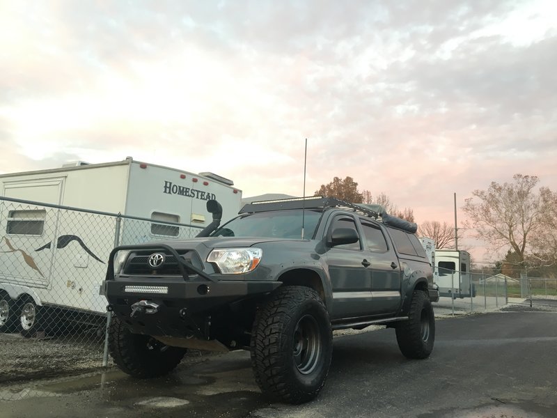

    I think I can change my thread title now

    Those look like 35's did the first time I saw them on a taco. SICK!

    Not having done anything yet, or checking full bump/lock. In reverse I rub on passenger side, should be able to beat that in. My rear tires rub the bedside, but I havnt cut anything yet so it will be fine.

    How do you turn haha, looks awesome tho
