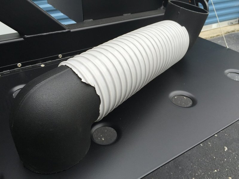

    So heres a visual for whoever is looking at buying a Airflow snorkel. This is the entire group of fittings, notice the flexible duct that would be used for a dryer vent, poorly cut that is. This is the only part of the snorkel that I thought could be air tight... well the dryer hose is about 1/4" larger so even with cranking the clamp down it will still probably leak.
    Im going to use silicone elbows like the ones used for intercoolers

    Haha yeah it thought the connections were really shitty too. I siliconed the shit out of them. Also when installing one of the nuts/stud on the snorkel fell into the snorkel body :mad: on top of it I deemed that very top stud impossible to reach haha so mine only has 3 bolts holding it :anonymous: it's better now that it's attached to the a piller.

    That top nut was a bitch, i unbolted the fender to pull it back to back. Still wanted to kill the stupid thing. Ill post what fittings I end up using if your trying to change yours, did you drill for your pillar? I just used heavy duty double sided foam tape thats used for small shelfs and such
