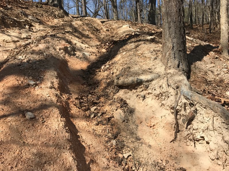

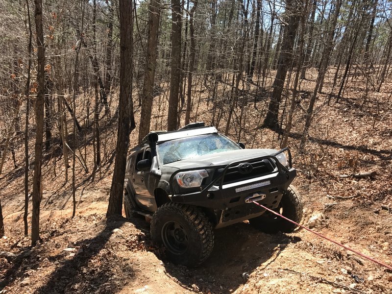

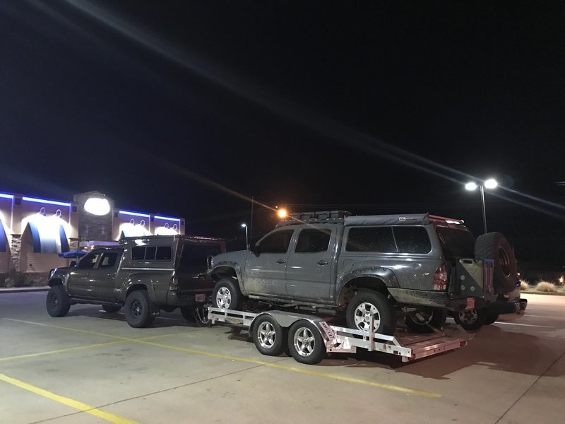

    Well went out for some wheeling today at moonlight racing, Only been once before and it was a group outing so I didn't get to see much of the park. I made it a point to see everything it had to offer, ran most of the trails besides the hard ones because they are clearly made for buggys/rock bouncers. Ended up getting off camber into a tree so I used the winch to pull my ass end around to avoid any body damage, the hill after this point made my body damage concern moot. The hill was pretty steep and most of the stuff has been loose for the day to I locked the rear before even trying it out without, passenger rear caught the large root and the rear end didn't care much for that so it popped right away. It was a pita getting the truck up without any power of its own, it took every bit of the winch doubled back to get it over the ledge.
    A jeep showed up and helped me get the truck up to the top giving my winch a break taking turns with his, even after on a slight incline he had trouble pulling me the rest of the way. But got to work pulling the drive shaft while he used my air to fill up, thankfully the top of this hill was right at the state highway. Jumped in the truck and started to drive and the truck made a loud pop and jolted the entire truck, I thought I had broke a CV so I checked both and thankfully were fine. Drove again and kept happening so I made a few phone calls and @G.T. offered assistance along with @MO Tacoma to trailer her home, I drove the truck to the main highway about 11miles away and I had no idea what would happen with how loud the rear diff was popping and clicking but I made it somewhere better to get picked up with reliable cell service so thats what matters.
    Tomorrow I get to pull the diff and see whats going on and get it ready for another 3rd, gotta love it

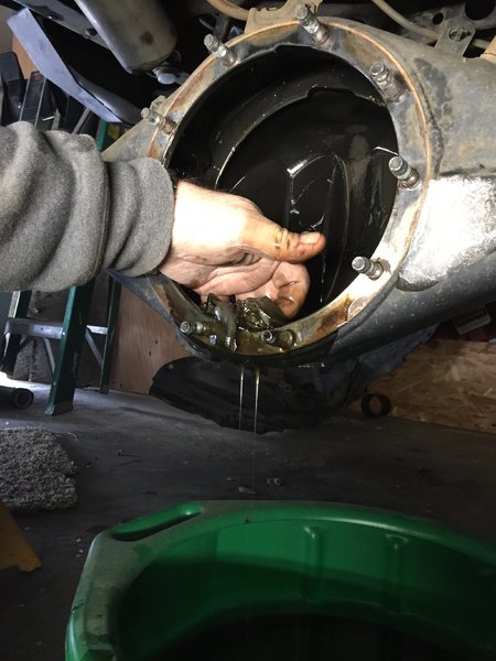

    your diff is going to be full of metal :D, same shit happened to me this winter and i had to get pulled 6 miles to the main road (so yours should be worse). My diff was fucked over real bad, and it took me like 3-4 hours to clean all of the metal out of the axle housing.

    Not what i want to read just before tearing it apart :(

    I took multiple hand fulls of that shit out then had to use a putty knife and magnet to get all the small pieces out
