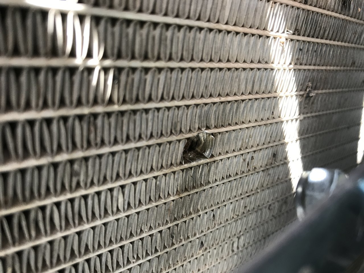

    Just my fucking luck, drilling a hole for the new transmission cooler and right into the AC condenser. Upgrade one thing, break one thing. Trying my luck with some marine JBweld by plugging the weld. Found some hit or miss information online trying to plug an AC system. Hopefully this shit works and I don't have to buy a whole new condenser, doesn't help that it's humid as fuck and 100deg

    "dislike" :(

    If it was me, I'd most likely have chipped the fan blade behind the whole pile.

    If any one has a lead on a condenser it would be greatly appreciated. The couple of pick and pulls around me don't have any tacomas so I am out of luck for local, would prefer oem before I buy a aftermarket one

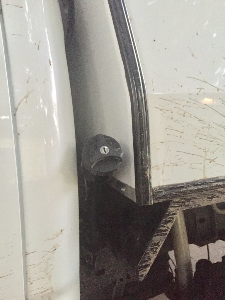

    Chandler, do you have a pic for the driver side of your tray/canopy? Just wanted to see how the gas filler tube will mount.

    Thats to be determined, I left the space blank so I could play around with a couple of different ways before I commit.
    Some people use wire to hold up the filler neck, some use a bracket, some use a aftermarket filler, and some graft the oem fill door area
    So I have plenty of options. I am just going to copy the section where it will go and play with a couple of different ways until I am happy and willing to modify the area where it will end up going.

    New condenser installed, Ill try to get a write up since I took some pictures of the process. Probably one of adding an extra transmission cooler as well

    Gotcha, I was randomly looking at other setups today but most of them were long beds. Even they didn't look like it had much space for the filler.

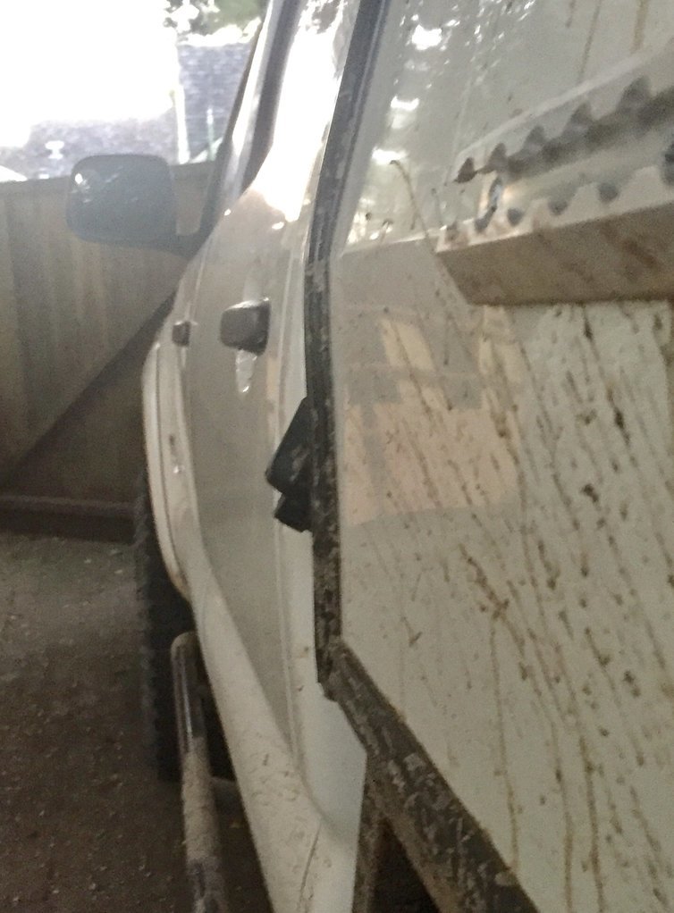

    This wasn't too bad. I read about issues with mounting it too low. It's hard to fill- up and some guys have to hold the nozzle or carry a 4"x4" to prop up that side. There is also a vent around the side of the nozzle. If you plug it, CEL codes. If water gets in and goes into the canister, then freezes, an expensive solenoid could be damaged. I read all this while deciding where the filler would go.
    I cut the metal overflow tube and replaced it with rubber fuel line. Couldn't get the right angle without doing that. Also bent the mounting bracket and adjusted the collar on the fill tube. Seems pretty solid so far and it might be a little higher than stock now.

    Good to know about the vent
    You have a picture of the cap off?

    I don't have a pic and the truck is at home. I can take one tonight.
    If you take the cap off, you can see curved slots around the outside of the filler hole. I believe those are the vents.
    Found the source of this info. It was a pump that can get ruined, not a solenoid btw. Posts #22 & #29.
