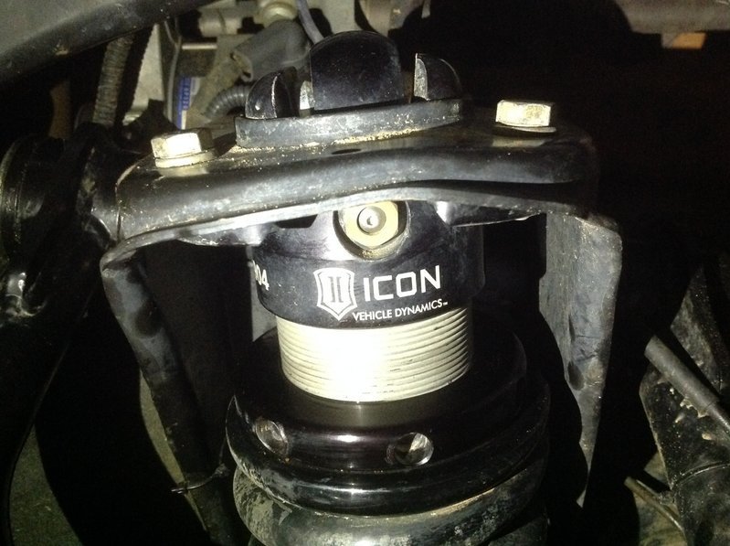

    I broke one as well. They don't like cranked coils much.

    Ya because then you get coil bind which results in all the force moving to the top hat. This could be an Icon problem because they use a 13" coil rather than everyone else that runs a 14". Their top hat could actually be weak, or both of these. Probably both haha

    I run a 14'' spring with basically no preload and mine still broke so I would say the later.......
    Or all of our bumpstops were setup improperly :notsure:

    I am almost tempted to reach out to everyone who has broken one, My coilovers were out of warranty so I had to pay for the replacement part which I have mixed feelings about. One hand its out of warranty and thats just it, on the other hand a part failed that shouldn't have especially with what I consider normal use 90% of the time its driven. If it goes un noticed (very possible since my wife drives the truck most of the time) and my coil bucket looked like this once I noticed it and was told whatever your coilover is out of warranty I would be pretty pissed

    That picture is a little extreme but even something like this I wouldn't be happy about. Lessons learned though, Ill just add them to the list

    Would coil bucket gusset plates that some companies make even prevent somehing like that? I could see bypass mount possible lowering the chance of destroying your coil bucket.

    I have the @dirt designs coil bucket hats that have a provision for a cross brace and secondary shock mount tubes and it’s easy to say that I think they would help but only in prolonging the inevitable. The overlooked weak link in the design is still going to appear eventually.

    Really they need to consider a different material for the top hat or a different design, once that breaks you are pretty much out of service either way since you really dont have anything keeping the top of the coilover in place besides the weight of the truck.

    Agreed. Definitely an issue in design that Icon needs to fix. Just curious if having some of the bracing would at least keep the coil bucket from cracking or bending to the point that it would pretty much total a vehicle from an insurance prespective I would think.

    possibly yes, but if your coilover is unsupported from he top and the truck droops enough to where the coilover falls outside of the coil bucket you are fucked anyways. Id be curious what insurance would do for a bent coil bucket, usually they just replace but at that point its the frame

    True. I've seen so many Icons like this over the past 3 years that I wonder what the ratio of failed components is. I'm not sure what to process is for replacing a coil bucket, but I would guess it would be a easy total being that it's the fram like you said.

    After I broke one I kept a spare assuming it would happen again. It didn't. The Aluminum doesn't flex, but the tower sure does and something has to give. Adding a second shock in there with a brace REALLY helps stiffen it up, and takes some of the load off of the coilover itself. After adding the second shock hoop I never had another one break.

    Thats a good point about the bucket flexing itself, so I guess a coil bucket mount may help more than what I would imagine.

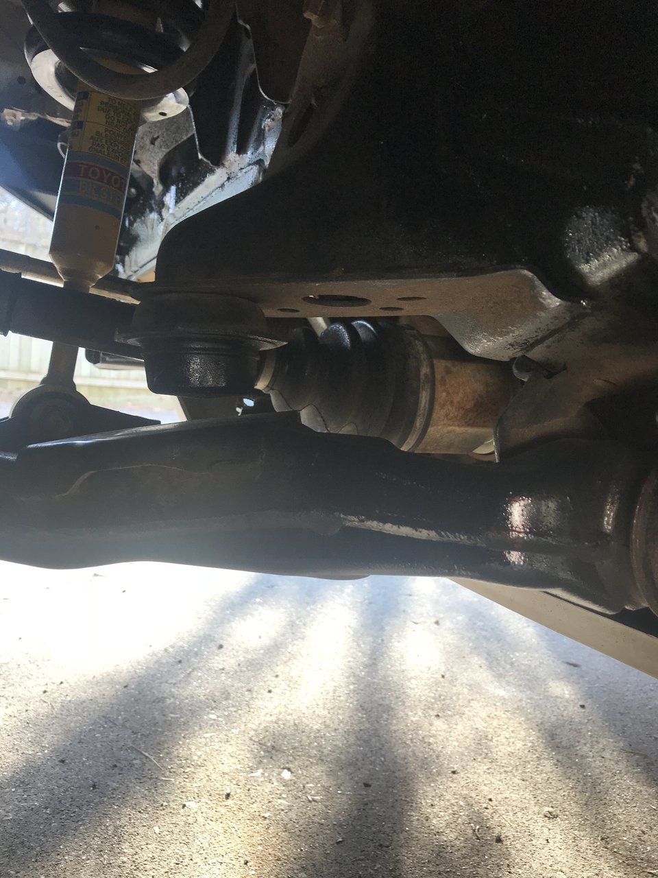

    Took the truck out for a short drive to see how it was on stock coils, Its a little too low and hit the bumps every time I turned or a bigger bump so I went back home after this to pull the front bumper off to relieve the stock coils of the extra weight. I have both trucks out of town so thats the reasoning behind doing some of this stuff, I have to get it home for monday
