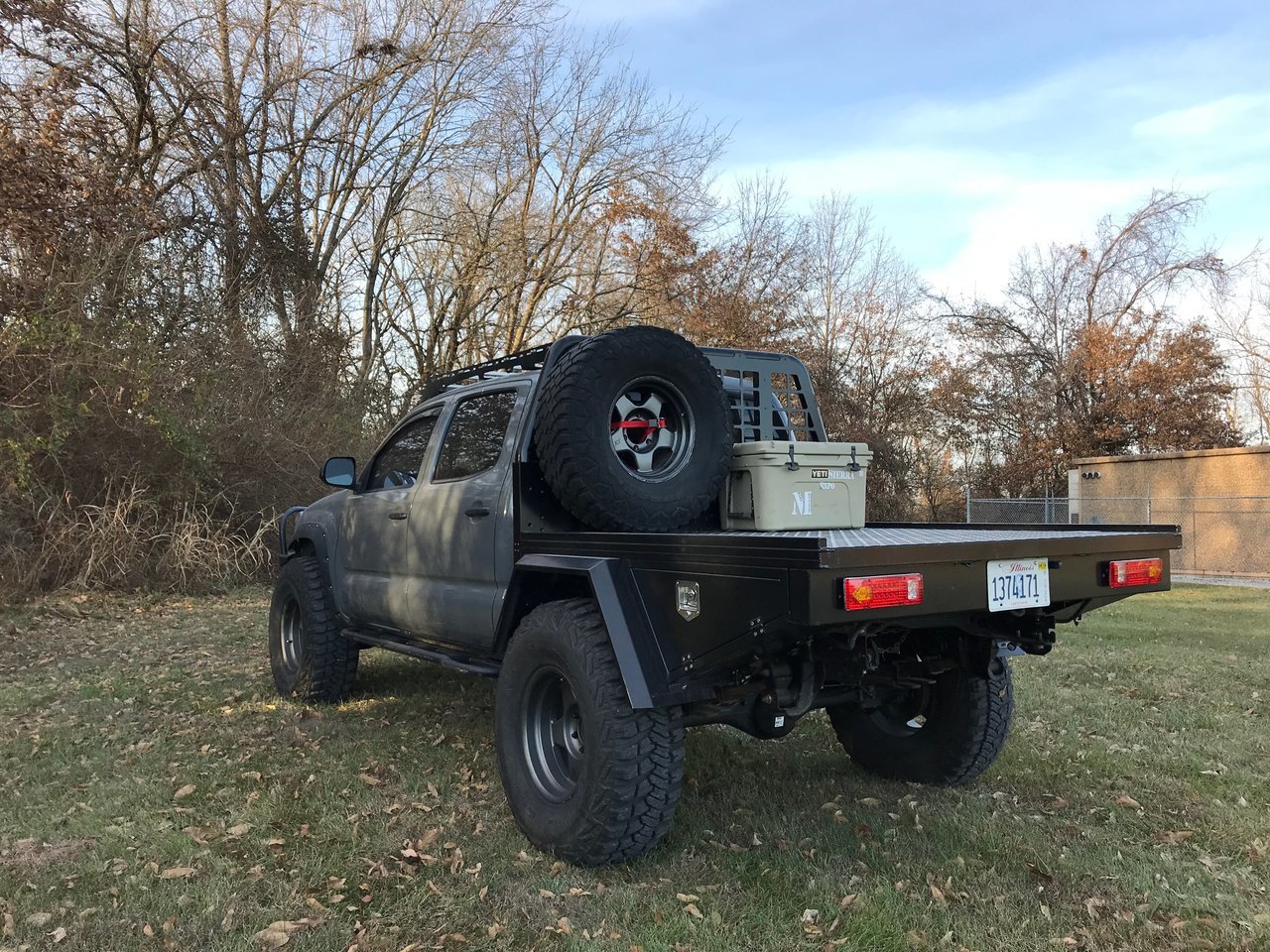

    Top hat finally came in, FedEx held my package hostage for nearly a week. Got everything swapped back over this morning real quick. Much better

    Great news. Tray looks different without the bar.

    Yeah I started to mess with the filler area, so I had to pull the bar out. The headboard is getting a redesign tho so It will look different on the next one.
