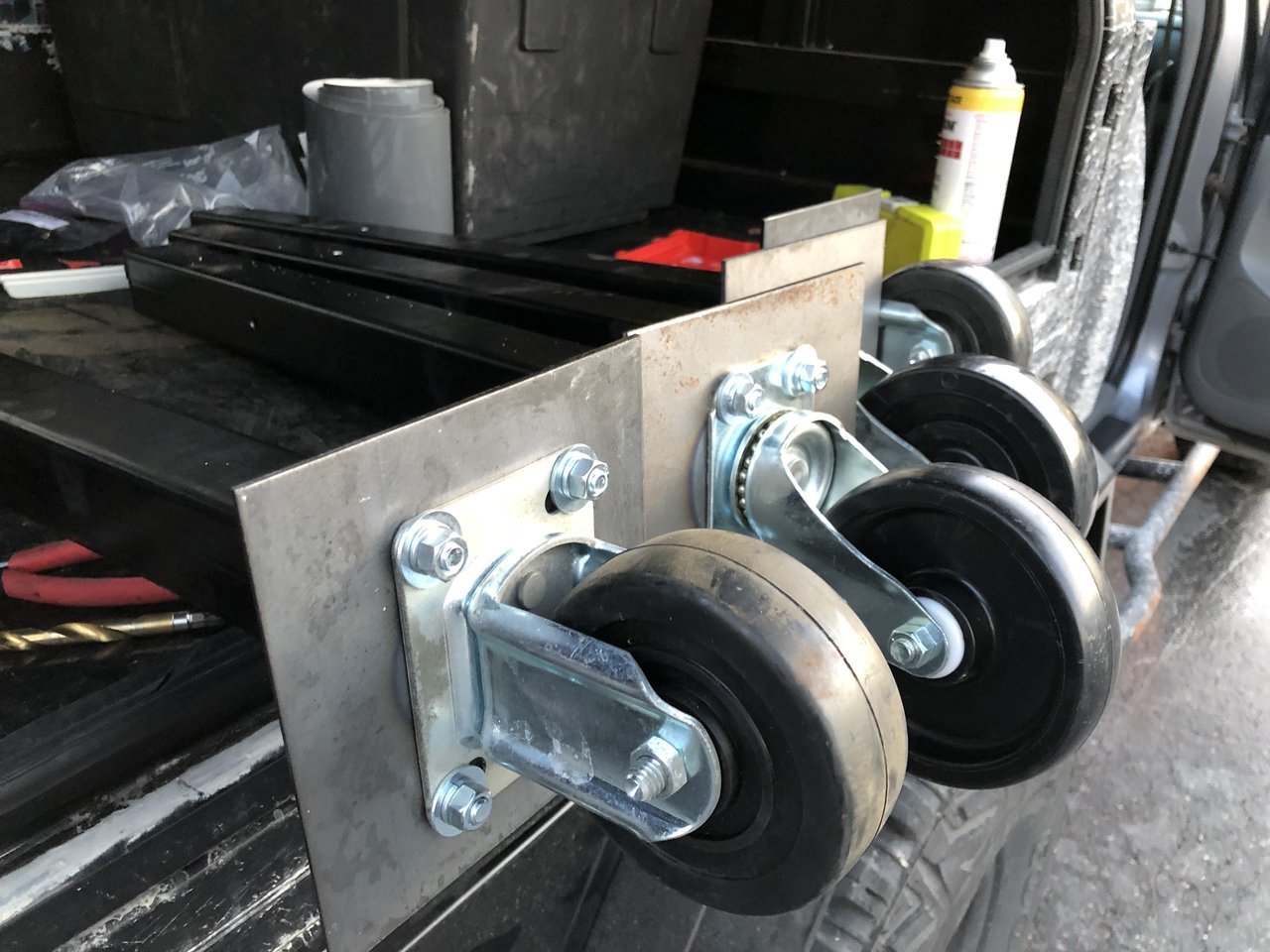

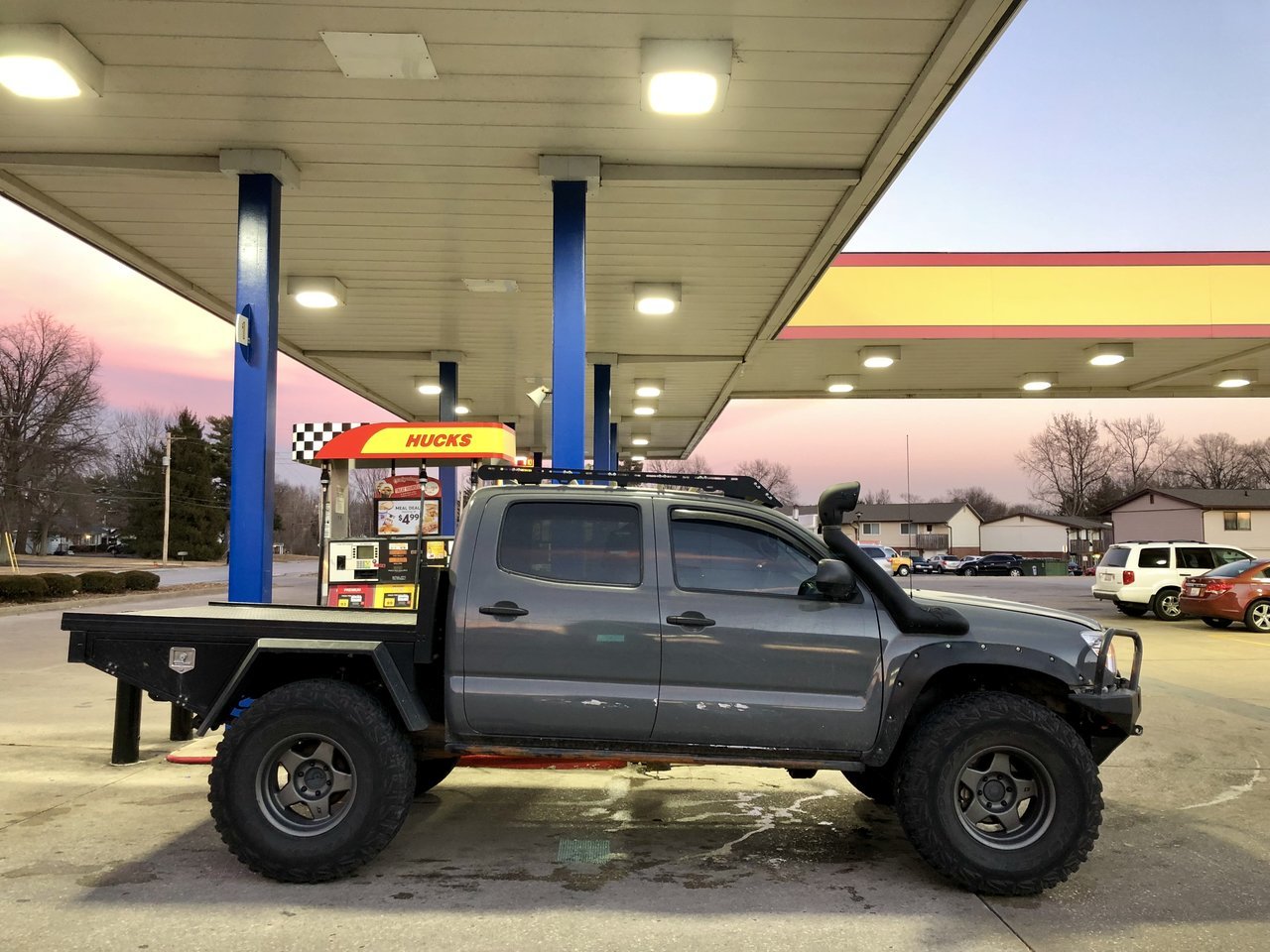

    Didn’t really want to go out in the cold but I needed to throw the canopy on for tomorrow, I got some leg extensions for the jacks so that’s good. Might throw some casters on some plates so I can just drop the canopy and roll it where it needs to sit rather than needing the truck to move it around. Of course the wife leaves it under empty so I had to snap a photo while filling it up, Love how it looks with just the flatbed

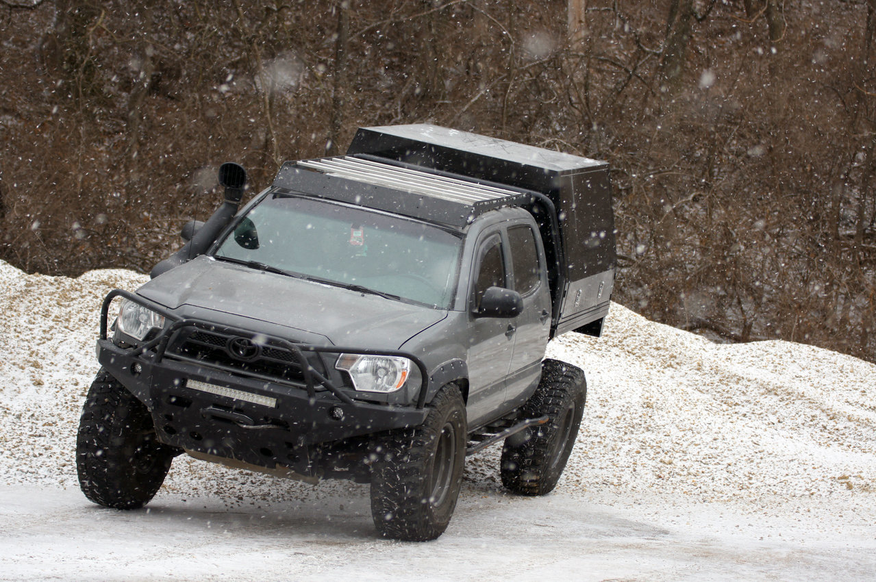

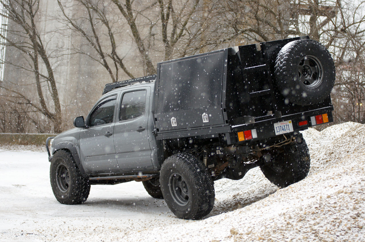

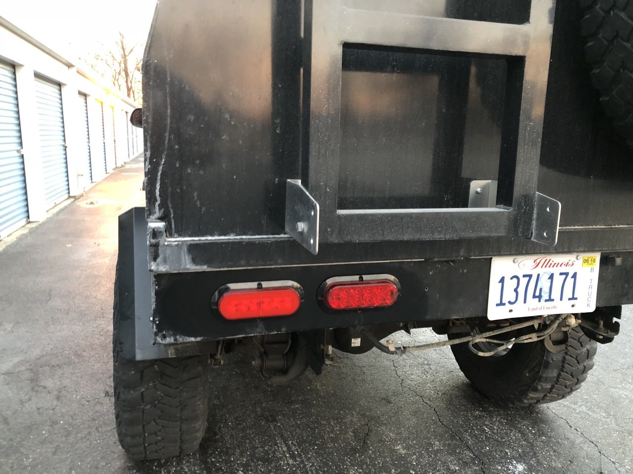

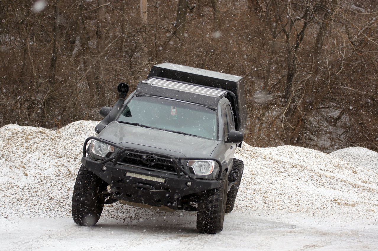

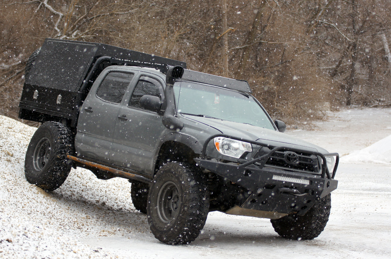

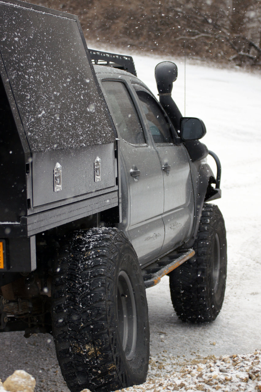

    Late night last night messing around, thanks to @MO Tacoma I was able to do a test fit on his truck to double check some filler neck clearance, also installed another set of tail lights and sure enough the brake and running lights run on the same leds so at night you can’t tell if I am braking or not :bananadead: so I had to wire up my extra light for a brake light to get myself home. Ordered another pair of tails, Might try to modify what I currently have afterwards or keep looking for something that I like
    Grabbed some pictures without the boxes or flares. Also Finally looked at the clearance on the tray under full bump, tire 1in from tray the bump has 2in left which is all good since it was all designed for a 35in tire.
  13. Feb 4, 2018 at 9:23 PM

    Got some stuff done this weekend. I got replacement lights of my first ones because they were 24v, well this set didn’t have separate leds for brake/driving lights so at night you couldn’t tell if I was braking or not. So I got new lights, I tried running everything off the one but when the brake was applied with the turn signal it canceled the turn signal so grabbed another set of lights dedicated to the brakes.

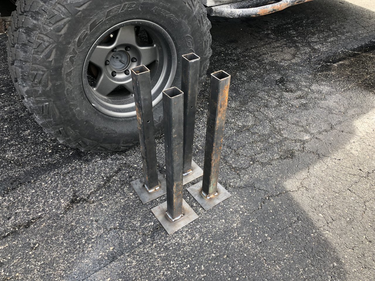

    Another thing I got around to this weekend was my extension legs for the lift off jacks. The jacks we’re too short for my tire/lift combo so I needed extensions. So I met up with @MO Tacoma and we welded up some feet for the extensions. Another issue I had is when I parked the canopy in my storage unit it was too tall and a kind of a pain in the ass to get it just right so I bought some casters so I could lift off the canopy wherever and just push it wherever I need to instead of having to use the truck to move it. Ran out of daylight so I didn’t get a chance to get it off the truck and see how it does rolling around but tomorrow I can take care of it.
