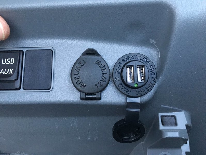

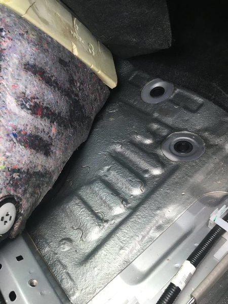

    Didn't plan on doing much today but I figured id try de beading a wheel so I could throw in some airsoft pellets to balance out the tires better, walmart didn't have any pellets so I figured I would just clean out the truck instead.
    So I found water under my passenger side floor mat, wasn't sure how the water get there so I started tearing the interior apart to lift up the carpet to get a better look. I checked my AC line and looked fine, maybe it froze and some ran into the cab. But the one grommet was pretty wet so I felt like that was the culprit. Hopefully it doesn't continue.

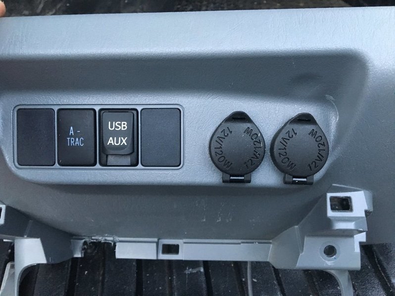

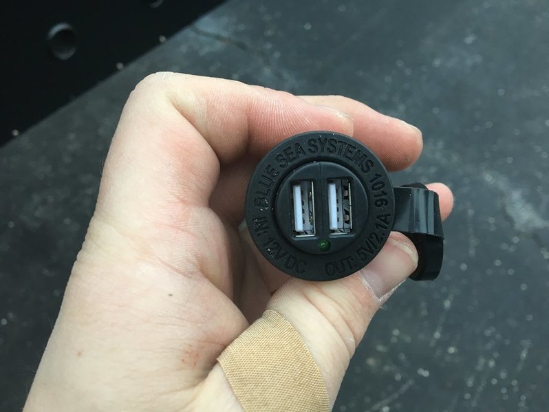

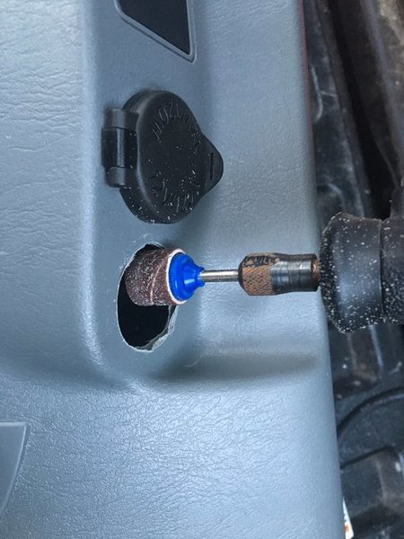

    While taking everything apart I thought about the blue seas bus port that I bought and planned using, I don't have much use for 12v so I planned on replacing one of the 12v with the blue sea. The size seemed close enough to be doable. Getting the trim piece was a pita, and removing the 12v wasn't fun either. The size was very close, but had some minor clearance work to get done with the dremel. Even with the cutout enlarged the 12v can still go back in and look factory. Im not sure how I plan on wiring it together, I want to use the 12v connector for the blue seat but I have to make a quick connect extension to make that happen. Im not sure the 12v will be enough power for the blue sea either :help:
    Well it got dark so I decided to leave the interior as is and call it a night, and after leaving work called saying I've been mandatory recalled back to work :frusty:

    What were you going to try to debead with? I tried using my motorcycle spoons but couldnt get any leverage against the tires. The sidewall would just squish in. Also tried running over a tire with the truck, that didnt work either, haha.

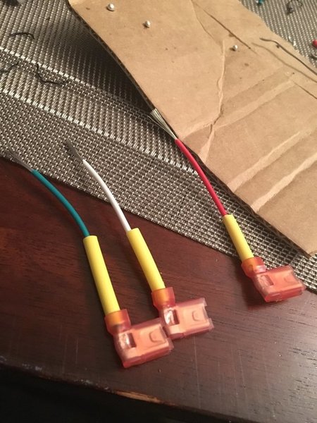

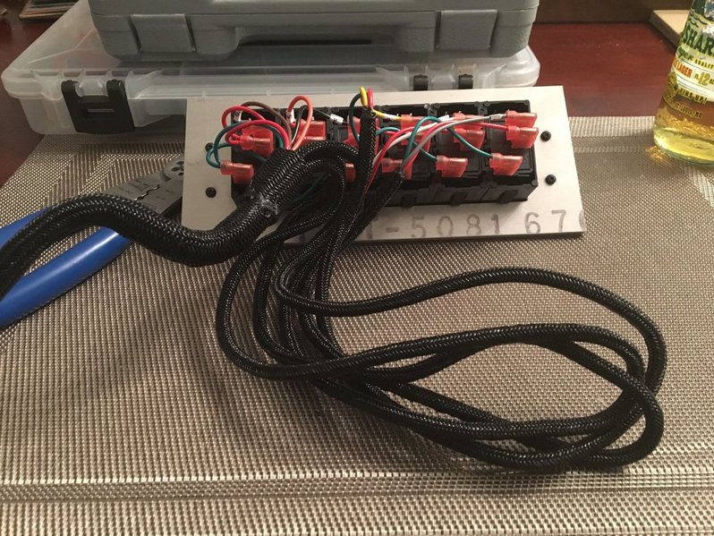

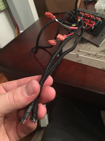

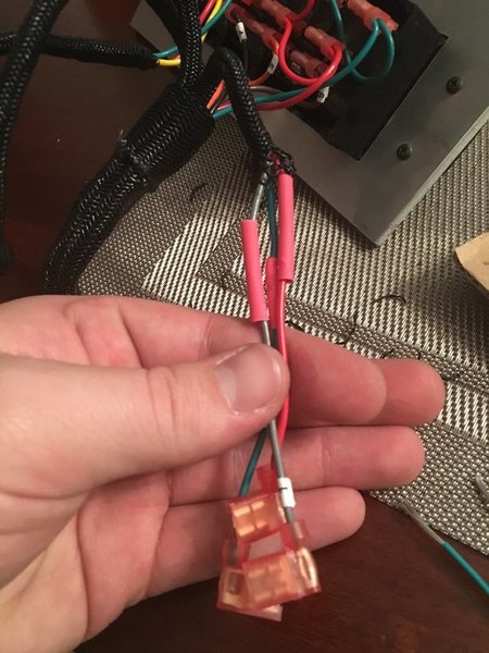

    While I have my entire center console and lower dash apart I took a look at my spod harness. Its made for having switches on the dash in different areas, hence the extra leads. So having all my switches in one spot makes it difficult having all the wiring going through the lower cubby. First time using a soldering gun, I think I need a better one like the pen type not the gun type. Lets just say I'm not good with soldering at all, but I made some progress until the gun started melting...
    I think I may order a new connector and re wire the harness. Even this way it has a bunch of bulk. Anyone know how to wire a rocker that has a lower independent into dash lights. So the text lights up with the dash lights but when thrown the symbol light is lit up. Do I just tap into a power that goes to a dash light?

    It should be that easy. Those small leds shouldnt draw enough current to require adding a relay circuit in.

    #698
    deeezy
    deeezy Well-Known Member
    Sep 1, 2013
    #111645
    5,253
    Dana
    Hawaii
    2013 4x4 DC, 6 spd, TRD Sport
    King ext travel coilovers, Icon tubular UCA's Rear-King "Tundra" 2.5's, Allpro Expos, TRD cat-back, Hurst/Core short shift kit, etc...
    Tap into your AC control lights. I don't know the color wires offhand but that's what mine are tapped in to. They'll come on with your dash lights and the top light will come on when you click the switch on.
