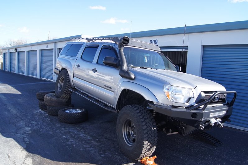

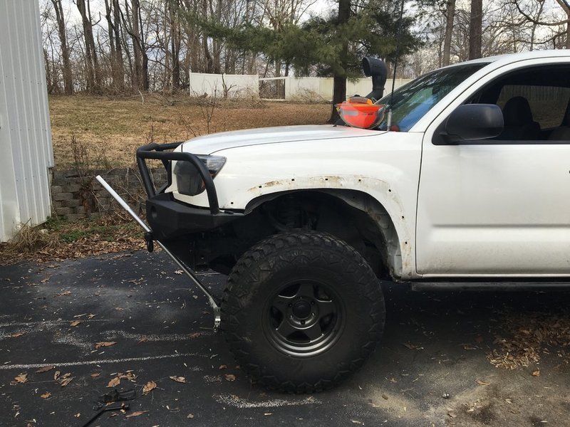

    Forgot I took this picture yesterday, looks so funny with the little tire and narrow offset

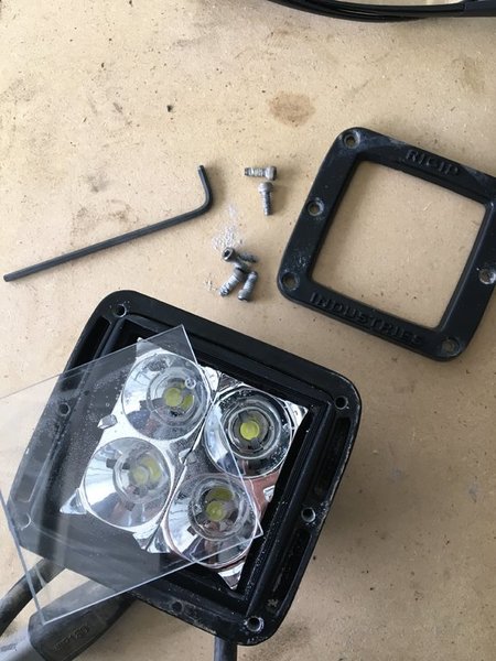

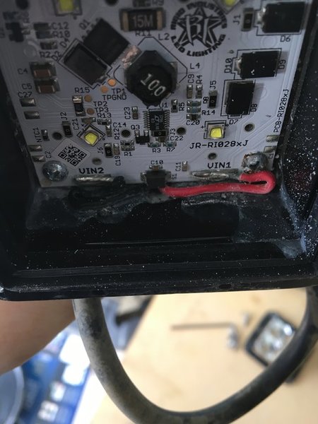

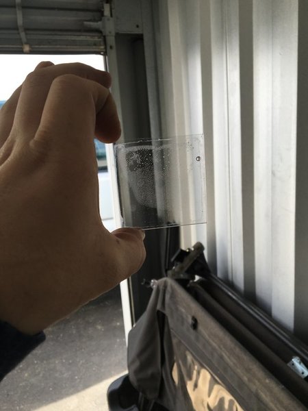

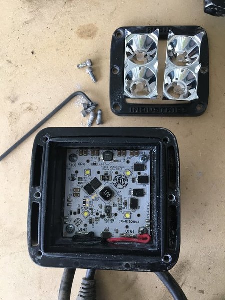

    Spark plugs done, all looked good except 2. May have got some water or dirt, looked clean except the threads on the plugs. Put my fog light covers back on, and took apart the one that had condensation. Pretty neat how its put together, I figured some sort of sealant but it uses a rubber gasket and the glass sits in the groove, the frame just keeps the glass in place it seems. Im wondering if I could swap out the insides for the DOT version glass and reflector bowl thingys

    this makes me want to get 35s and a bumper so bad. looks good:thumbsup:

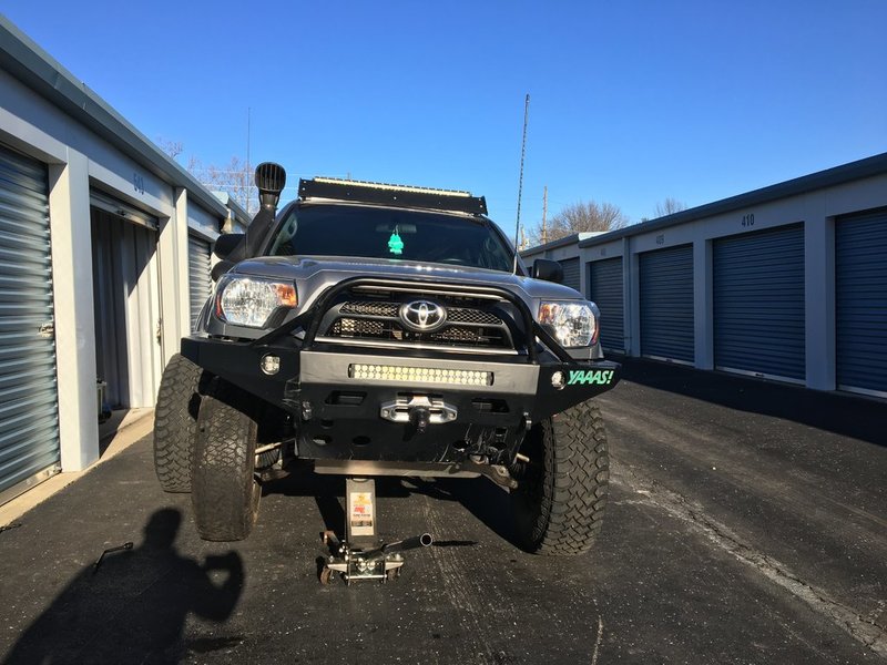

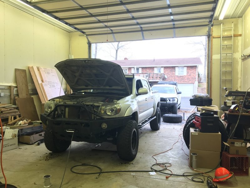

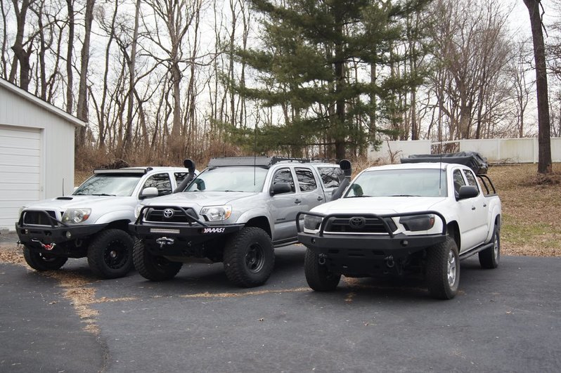

    Met some cool dudes today at @Palehorse1 place with a nice area to work on the trucks, @Sacrifice Cleared for 35s and @HIYota Installed his comeup winch from the group buy that I should have taken part of. Me and GT just gave a helping hand but it was a good time and hopefully this continues. Some pictures from today and some from the other day.

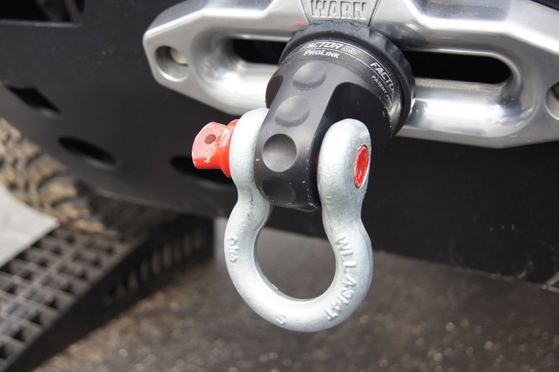

    Also I've read from multiple different people that ARB D rings do not work with the factor55 thimble so I decided to check for myself since I have a ARB recovery kit with 2 D rings, I wanted to see if I needed to swap them out with ones that will work with the thimble but they worked just fine.

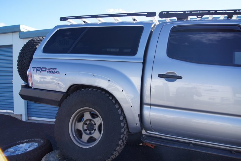

    How much did you take out of your rear fenders buddy?
  18. Feb 1, 2016 at 12:46 PM
    #818
    ChandlerDOOM
    ChandlerDOOM [OP] International tent trafficker
    Nov 4, 2013
    #115943
    3,838
    Chandler
    STL
    Truck
    37s yo
    Zero, I only rub very slightly in the rears. Flares have to be trimmed, but rears are dependent on your suspension
