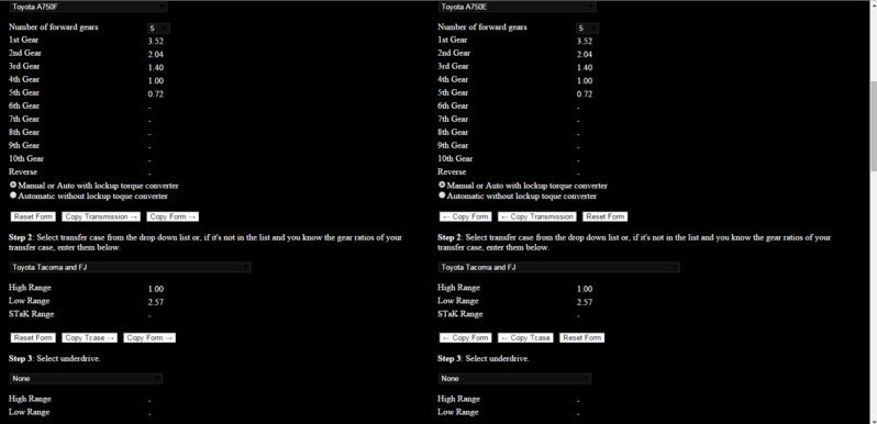

    Whatd you use? I thought the 2nd gens had the a750e?

    They do but my understanding is A750E is the 5 speed auto found in 2wd and A750F is found in 4x4 models

    Ah. Dont know why the numbers are different though if its the same gearing :notsure:

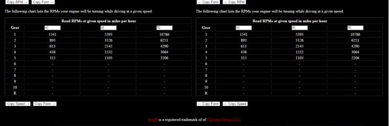

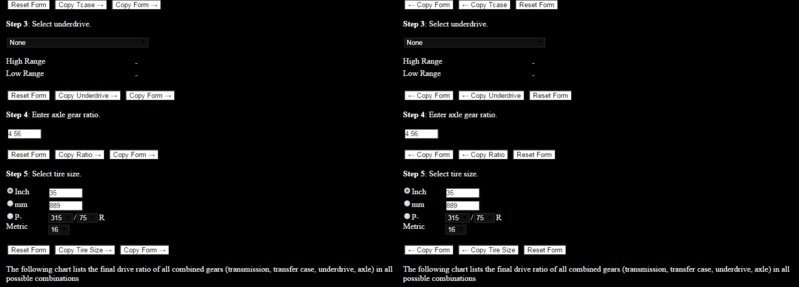

    @ChandlerDOOM i still get the numbers i posted using the a750f.

    Hmm looks like I got the numbers mixed up, yeah your right. Not sure what I did different :confused: Still going 4.56 tho but gears may have to wait now if the quote I get back is decent for some other parts
