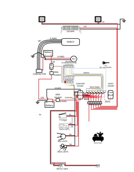

    That's exactly what my plan was. I wanted to keep all additional electrical stuff separate and isolated. The only link is the Blue Sea ML-ACR wich carges the second battery. But the neat thing is that I a situation where I've lent out my second battery to get someone home off the trail, I can still run all the lights, comms, and fridge by manually linking/latching the switch. As for the monitor, my solar charger can tell you the state of the second battery if needed. Plus, I got that dual battery monitor from ebay which will eventually get installed somewhere.

    This is a partial layout I made up a while back of what I had planned on doing. I'll get around to updating it one of these days. As you can see, the only thing drawing from the starter battery is the winch.
    When I get it updated with the solar setup I'll let you know.

    Thats awesome, that doesn't make it seem so bad. What program did you use to make the diagram?

    Haha. Microsoft Paint. The basic program on all computers.
