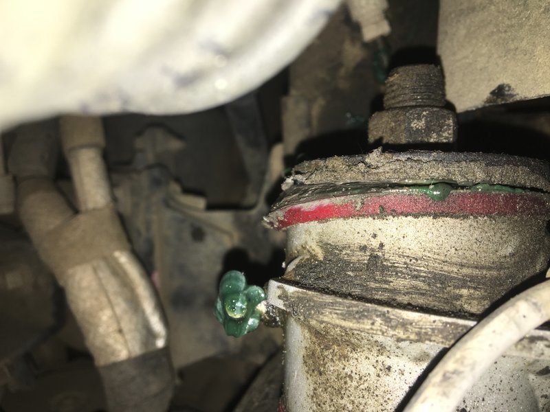

    So I'm back from our little trip after the wedding, got plenty of non tacoma pictures for once lol. Actually only took maybe 5-6 pictures of the truck. But yesterday I changed the oil and greased the UCAs, they were pretty annoying the entire trip and really didn't start making noise until a week before the trip (bushings that is) So today I decided to change out my wheel bearings and that went mostly without a hitch besides the CV nut :frusty:
    While doing the wheel bearings I noticed it was really hard to move the UCA, usually it just drops down when its disconnected or at least easy to move. So I looked to see what the issue was and the side bushings are actually coming out and folding over, you can see in the pictures. But how does that even happen, hopefully Allpro can help me out cause I probably can't use those side bushings anymore since they are likely deformed now :bananadead:

    SAS or LT time. Maybe caused by over greasing the bushings? That would be a hell of a lot of grease though...

    Well the stock UCAs are going on for now, maybe LT. I guess it could have been from greasing them, but I find it difficult to believe that the grease actually pushed that bushing out that much. But I never actually looked at them while greasing, or atlas paid attention.

    If you have a good grease gun like Lincoln then pushing them out like that is very possible. First time I used my new gun I did that same thing. Use a pick to press on the ball in the grease fitting. They will go back to normal if over greasing was the issue
