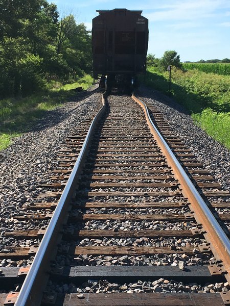

    Soon as I get inside my phone is ringing, The track buckled in several places so I had to head back to work. Didn't get done until midnight and still needed to be up by 4am for work today :bananadead: Well since it was so many places it buckled they want us to work tomorrow to destress more track that might be a problem. So no free weekend for me, but today after work I decided to get a jump on the list of shit to do

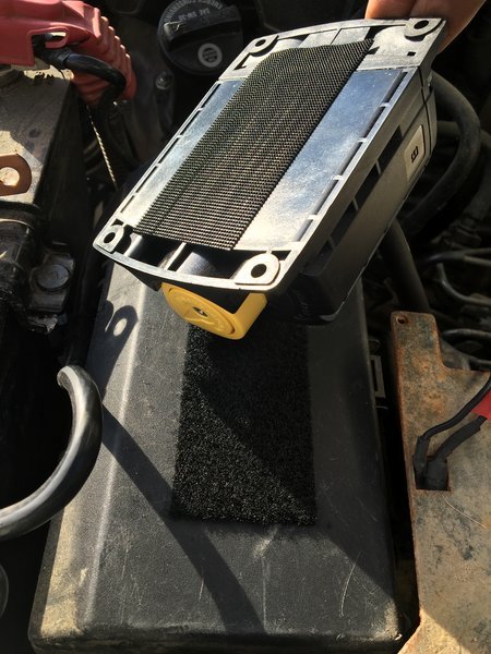

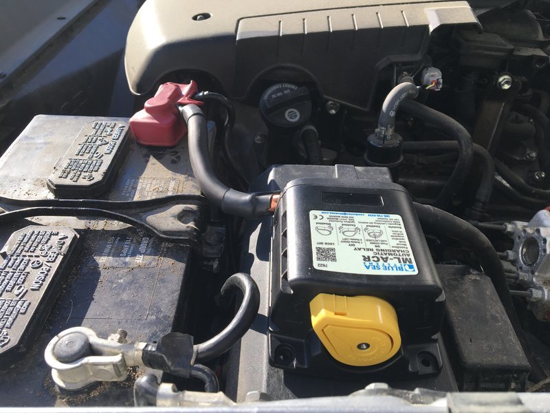

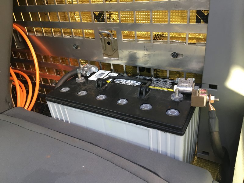

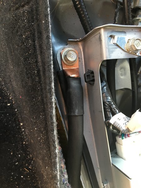

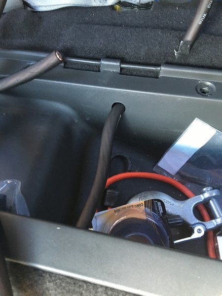

    Officially dual battery now, only missing the remote switch. I ended up running the negative cable down under and through the seat storage area and follows on the bottom of the transmission tunnel underneath the carpet to a factory ground on the side of the inverter. The power wire runs along the edge trim pieces from the front to the rear. The idea was to have everything completely hidden and unnoticeable. Huge shout out to @Nate87 for leading the way and guidance through PMs, I only followed him.

    Setup is looking great buddy. What causes the tracks to do that?

    To keep it simple heat causes it, rail expands and contracts with temperature. Too much rail with heat and the track buckles and not enough rail with cold the track will break depending on the temperature. So in this case, the track has too much rail and the temperature is too hot. Normally the rail would be able to expand and contract without issue if installed at "target neutral temperature" or pulled to account for temperature difference. Lots of variables and not much I can do about it but go out and fix it when it happens.
    This past week and the following 5 weeks we have been "destressing" the rail so this wont happen and throughout 60 miles of track we will take out about 24ft of rail, thats a pretty good chunk especially when the track will be the same length even with 24ft taken out. Its pretty cool sometimes when you cut a 4 inch gap in the rail and it will grow back together almost instantly when you have too much rail
