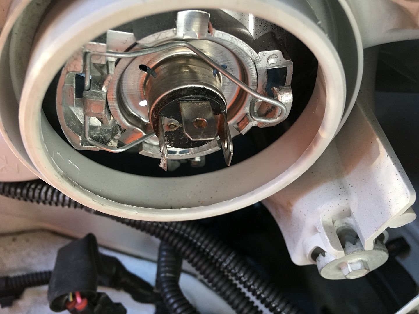

    The biggest problem with the clip(s) is that they can fall out. This usually happens at the absolute worst possible time too. Like when I was 1,300 miles from home at a hotel on a 20 degree evening and I went out to change a passenger side bulb in my 2014 Tacoma - which I had done many times. Yea, that wasn't fun.
    I keep this pic on my phone just in case I ever need it now even though I no longer own the Tacoma. BTW, A little dab of RTV where the clip rotates in the housing will keep it from ever falling out again.
