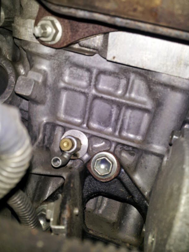

    I just recently did this. I didn't replace the hoses because they looked fine, but I did do the thermostat since it's cheap and easy. Here's what the block plugs look like. Passenger side is easy, you just need a long extension and a 10mm.
    Drivers side is a little trickier. I took off the wheel/tire to make it easier, and you need a U joint to get it lined up.

    For the block drains it might be a good idea to shoot some PB Blaster on them every day for a few days before you do the job. Mine were damn tight and I was reluctant to put a ton of muscle into it since I didn’t want to break them.

    If you pull the rubber or plastic-like covers in the wheel wells, you should be able to visually spot the drain valves. You can also turn the valves from there; although the driver-side is a little trickier and you will need a long extension. If your truck is not raised, you may need to lift up the front end about two inches. Ditto on the hoses, they should last 150K, your next coolant flush. I replaced mine at 100K and they were in near perfect condition. I've kept them as backups. Also replaced the belt and thermostat. BTW, I'm an advocate, and practitioner, of universal coolants - SuperTech, Prestone, etc.. Just read the manufacturer's directions and you will not go wrong. No need to purchase pricey red Toyota, or equivalent, coolants.

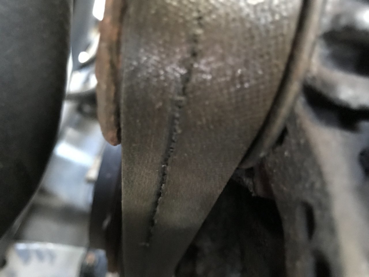

    Just changed my belt at 95k had a nice split in it33A62BF1-20CB-41FA-BD43-8FA7AA9748FD.jpg
