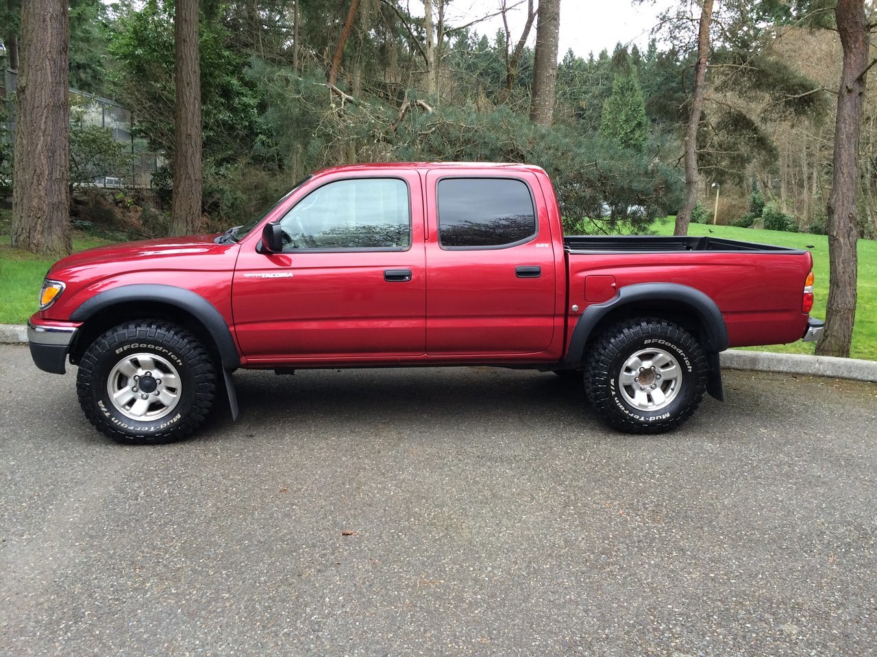

    As mentioned above, yes. I swapped my 2003 16” wheels for 15” as the tires tend to be lighter and cheaper in that size. An inexpensive way to get a quality wheel correctly sized for the truck is to pick up some used 15” Tacoma/4Runner wheels from a 95-00 truck.
