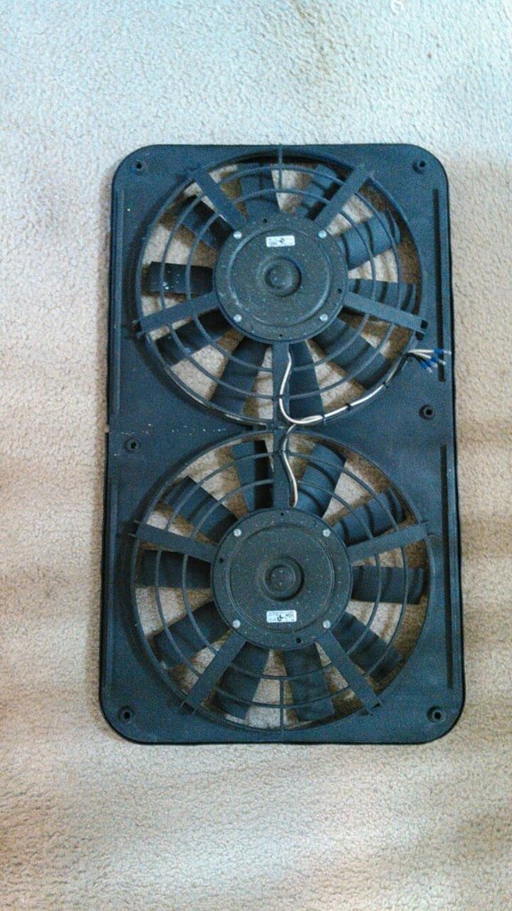

    You need this dual electric fan mfg'd by Flexalite . It has dual 11" diameter fans that will push 2500cfm thru your radiator . This style fan actually is made for toyota trucks
    This fan is what I'm using on my 72 Camaro that has a 600hp sbc and keeps coolant temp at 185deg on hot muggy summer days in Middle tn
