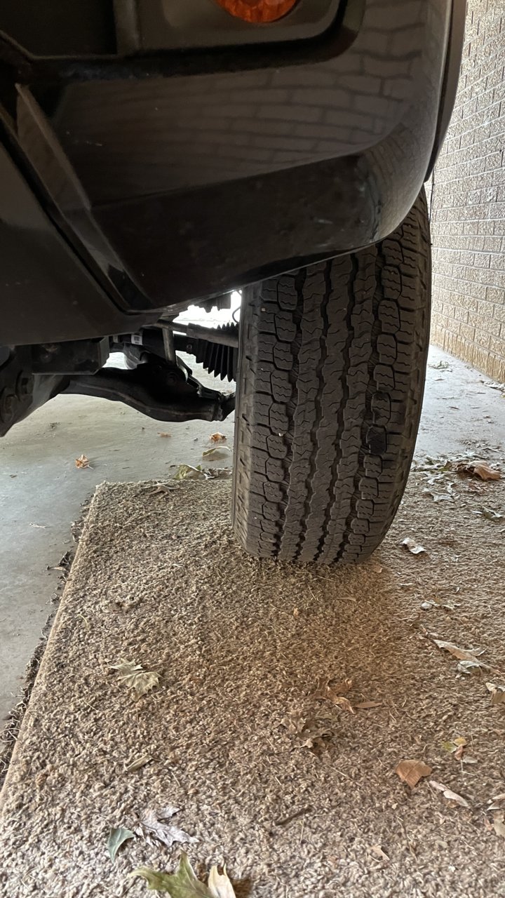

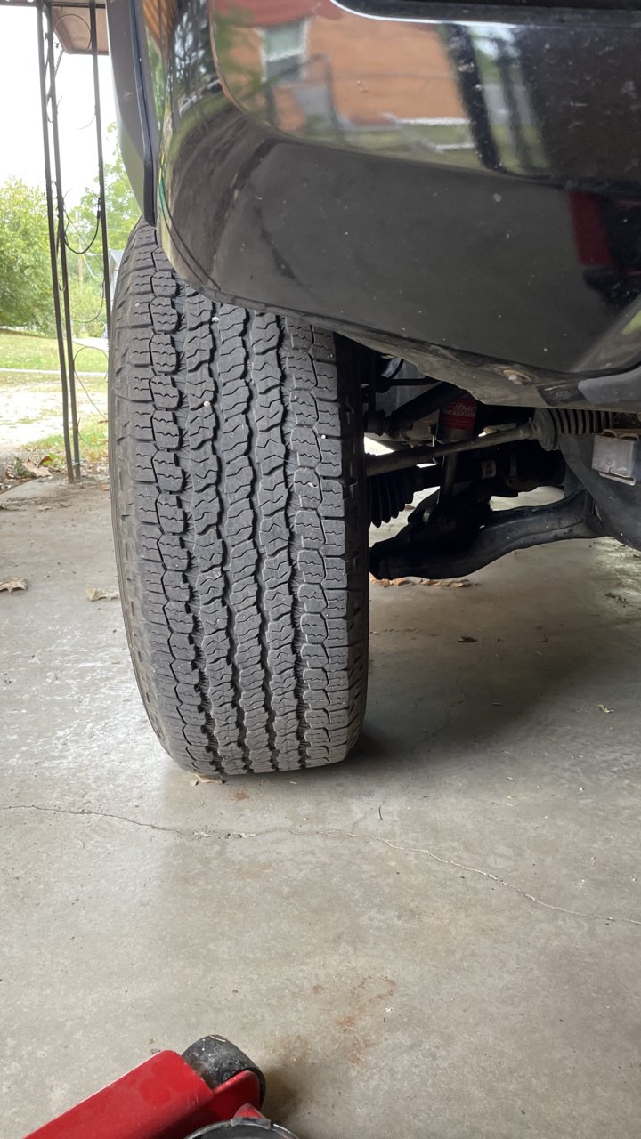

    So I just measured
    on the ground hub to fender is 23” passenger and 22.5” driver
    jacked off the ground measurements are 25.75” passenger and 22.25” (ish) driver
    This would mean I’m at 2.75” of travel?

    After I got my upper control arms, I got an alignment but they didn’t give me the numbers. Just eyeballing it, it looks like I have some positive Camber on both sides as well, could this be something?

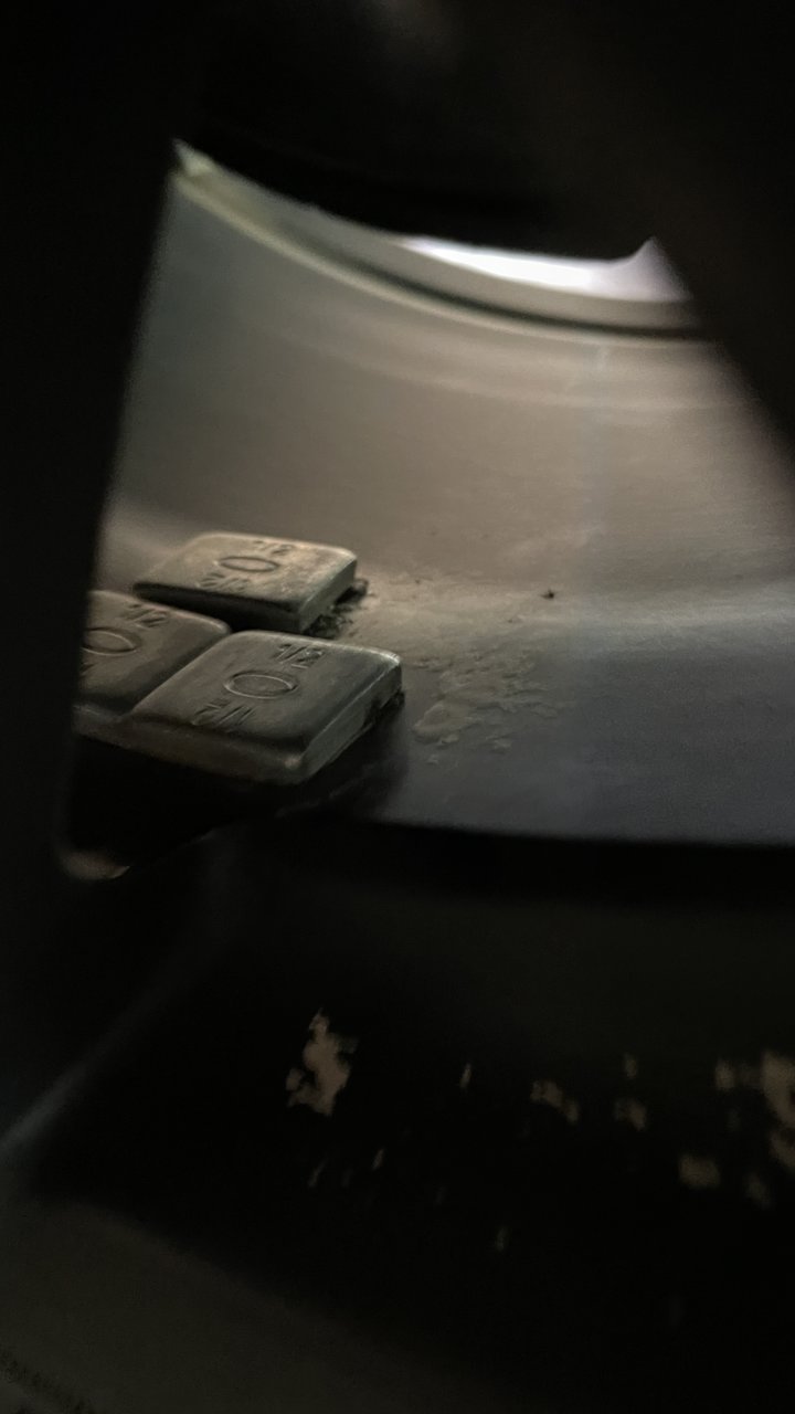

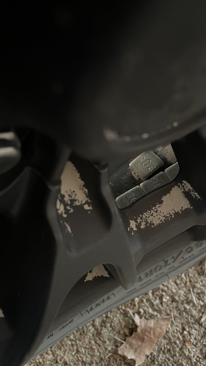

    Also, I haven’t had my wheels balanced since I got them like a year ago, and of course it was by Wally World so they seem kind of loose (I can slightly move the weights if I push on them. Here are some pics below

    Alignment won't change the suppleness of the ride as much as you want it to, just help the truck track straighter (and obviously help with tire wear and if properly castered - drive easier).
    With no weight in the truck and learning you have the RXT in the rear, your whole truck is oversprung. Front springs are about 100lbs too stiff and the RXT is not happy unloaded. I do not miss my RXT packs at all.

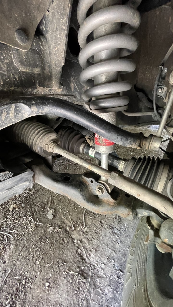

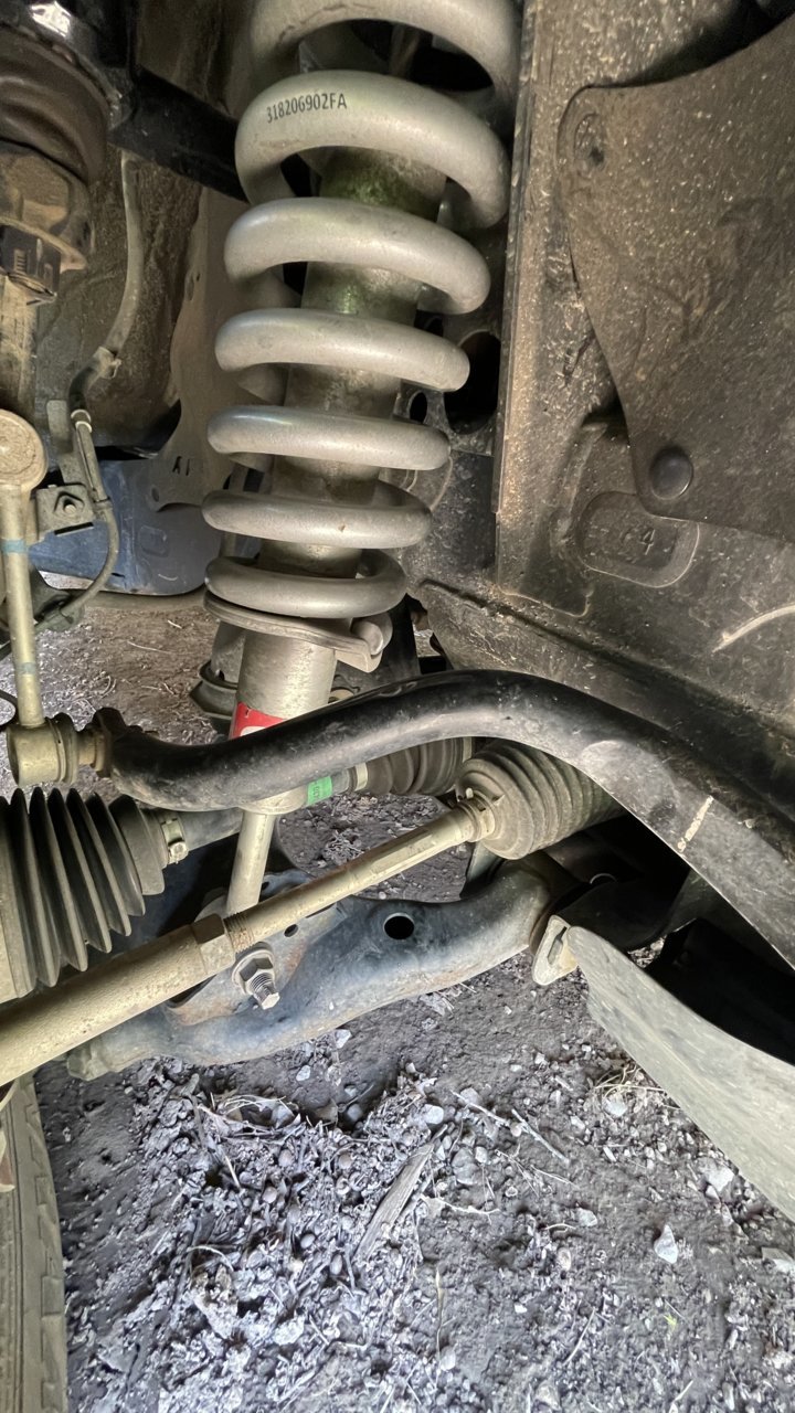

    Are your lower coil spring perches installed correctly? I recall there being an instance or two on here where they had them flipped and it was creating a terrible ride. Just another thing to double check.

    I believe so, I had them assembled by Wheelers Offroad when I purchased them. Here’s some pics
