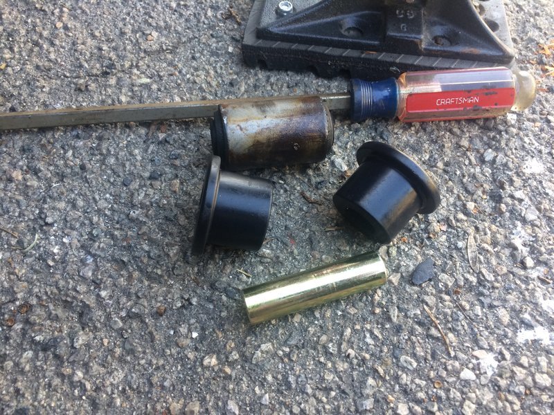

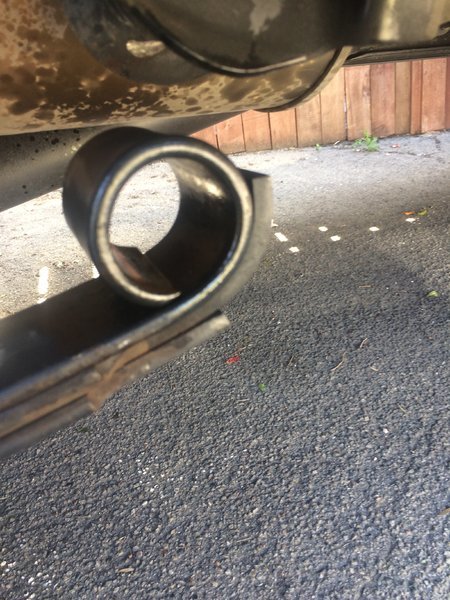

    I went through the trouble of doing this simple upgrade this past weekend, and just wanted to share the info. A quick shakedown afterward tells me I should've done this a year and a half ago before I installed the leaf pack, but I didn't think it was necessary. It would've been a lot easier with the leafs off the truck, but it's not entirely difficult to do the swap while the leafs are still installed by the rear shackle.
    Here's the issue:

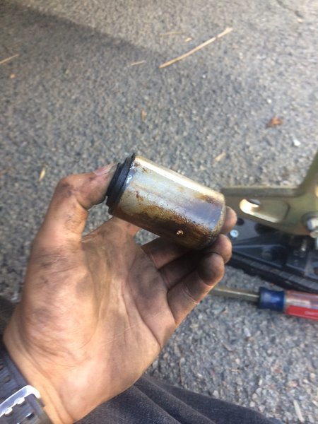

    The front rubber bushing that comes installed in the Dakar leaf pack is "pressed" in place. I put that in quotes because it really isn't difficult to remove the bushing and that tells me the bushing isn't held in place with too much force and results in it having some give and can walk out of alignment with the front spring eye. Everyone knows that Dakar are squeaky fucks, but for a while now I found that most of my squeaks were coming from the front spring eye. A quick inspection showed me what the problem was: the bushing had walked out of place and the steel spring was rotating and rubbing on the front spring hanger. The front hanger has about a 1/2" of room total after the leaf pack is in place so the eye can move slightly from side to side even after torquing everything down. Here you can see how far out the bushing had moved out of place:
    The result of the rubbing and source of the squeak:
    You can see that the paint had rubbed through where the steel spring eye was rubbing against the spring hanger. As a reminder of how loose the bushing was, a couple of whacks with a ball-peen hammer knocked it out of the eye. It seriously didn't take too much force. The spring eye after removal was clean and showed no signs of rust or wear:
    The overspray in the background was some PB blaster that I used before even attempting to take the bushing out. Don't really know if I needed it or not, but I suspect it would've come out just as easily without. Here's the bushing after removal:
    It still looks good and has plenty of life in it, but will not be reused in the springs. Surface rust was minor and expected.
    Comparison of old vs. new:

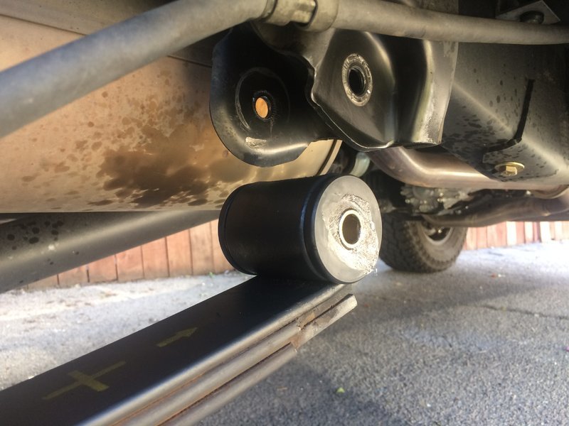

    The new bushing is a Wheeler's off-road polyurethane bushing. The same one I installed in the rear spring eye when I first installed my leafs. Comes with the small packet of Prothane grease for install and I recommend using all of it on the bushing and the contact faces. Here's the new bushing in their new home and all lubed up:
    A little more grease was applied to the contact face of the bushing after this picture was taken as well as inside the spring hanger. As you can see, the small shoulder on the bushing that sits outside the spring eye will prevent the spring from making any metal-to-metal contact in the future and help the leaf spring seat better in the hanger, taking up more of the useable space inside.

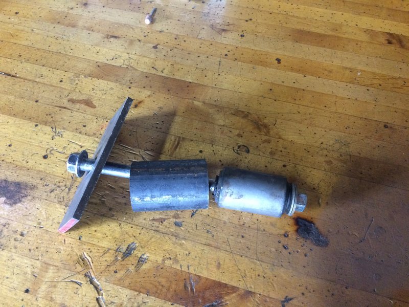

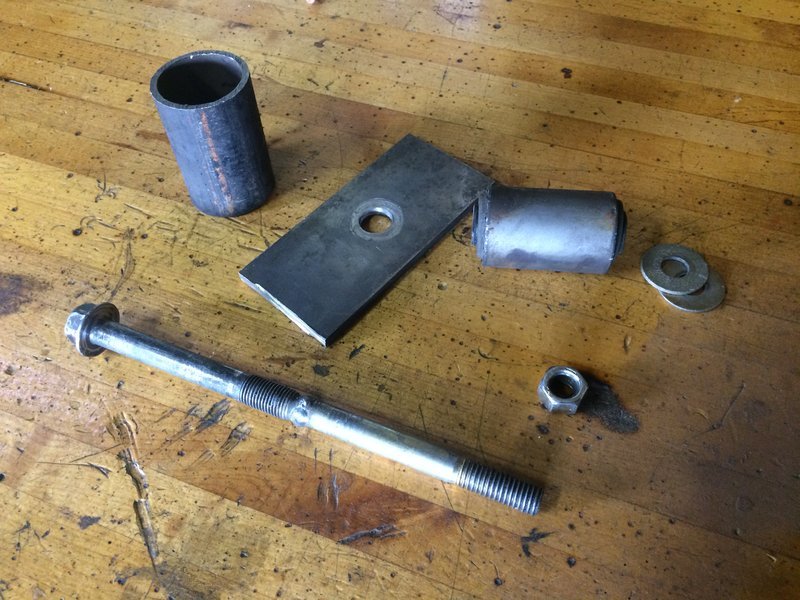

    For some reason, the driver's side bushing didn't want to come out as easily as the passenger side. Whacking and spraying with PB blaster did nothing to move it even though it had also walked out just like the passenger's side.
    Me: I need a puller and I don't have one.
    Also me: Make one.
    Used some scraps I had laying around and welded a couple bolts together and used a small length of pipe to pull the stubborn sumbitch out.
    I'm posting this because the truck rides a lot smoother now and the squeaks are all gone hopefully to never return. In hindsight, I say again that I should have done this before I installed the leaf pack in the first place, but it wasn't that hard to do on the truck. Total time spent was maybe 1.5 hours using a hi-lift and a floor jack and hand tools (including time spent cursing and taking pictures, but not counting trying to figure out and making the puller).

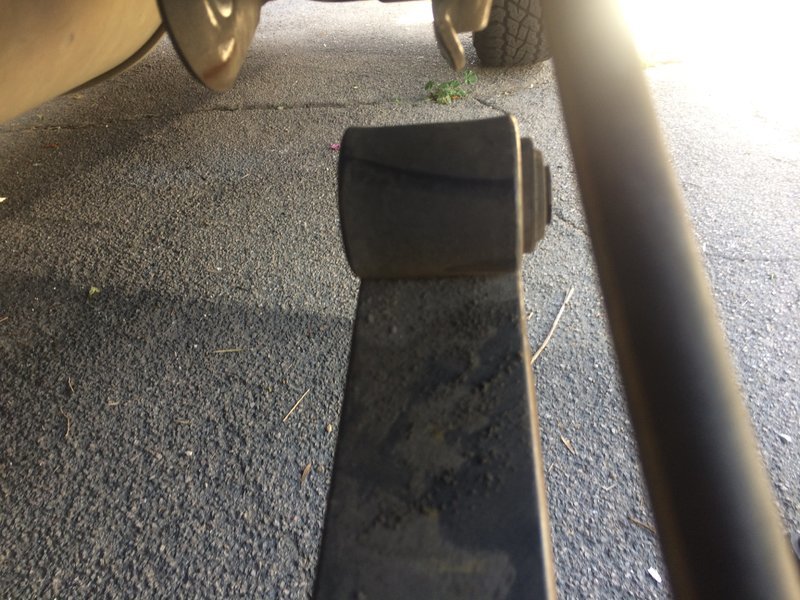

    I should also add that the second part of this project was to remove the rear shackle and grease the bushing faces on the spring and shackle. The stock bushing in the shackle doesn't have a risk of walking because it is captured with internal sleeves and has a shoulder that sits outside the shackle mount. This means two things: 1. It's in there pretty good. 2. It's a bitch to get out if you wanted to switch that one to a PU bushing as well. I don't see an immediate need to swap the shackle bushing out, but since it is rubber it is still considered a wearable item and maybe down the line time can be taken to replace it with PU if necessary. A cheaper solution than buying a new complete shackle.
    A recent conversation with @Crom turned up some interesting information that the bolts for the rear spring eyes and shackles could be overtorqued causing binding at these points. I suggested he back the nut off his shackle bolts to see if that helped regained some down travel in his suspension and it worked. I ignored my own advice until now and that's why I also greased and retorqued the rear (lower LBS with blue loctite). Three days of driving later and I can already feel a difference in the rear of the truck. Completely changed the manners on and off road.
