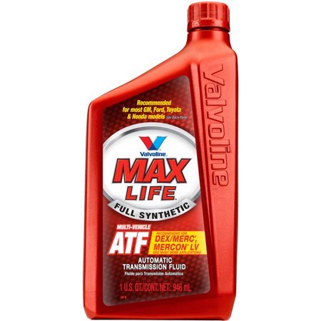

  5. Sep 28, 2020 at 5:59 PM
    Plain Jane Taco
    Plain Jane Taco Well-Known Member
    Apr 19, 2009
    #16179
    40,279
    USA
    Maxlife
    ABNFDC likes this.

    I would do this.
    Drain and fill is cheap and easy. If you get all sorts of crap draining out, consider the complete flush later.

    There was just a Maxlife deal on Woot for $25 for 6 quart bottles. I like the quarts better than the gallon jugs. Sold out now, but I got a 6 quart case-that is two years of transmission drain and fills for me.

    Been running this for years in my daughter's Yaris and brother in law's Sienna. Eventually it will be in my Taco's tranny. Already in the power steering
    ABNFDC[QUOTED] likes this.
