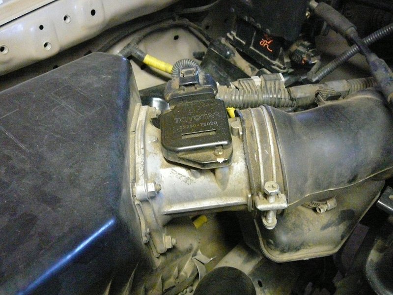

    Did you disconnect the MAF connector, and forget to re-connect? Just a thought

    I don't know what a MAF connector is or where it's located. But thanks for your reply. Could you clarify a bit more please? Thanks

    MAF sensor= Mass Air Flow sensor
    You mentioned disconnecting the intake, and thats where the MAF is, just down-stream from the filter housing. I have a 2.7 motor, so I'm not sure exactly where yours is located. Here's a photo of mine :
    It right in the center of the photo, and the electrical connector is on the back. You may have disconnected it as part of your project.
