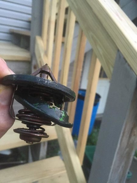

    Hey,
    New to the forum, as well as working on my truck. I have a 2002 2.7L Tacoma 3RZ. I'm to the point where I don't know what's going on.
    I recently replaced the cylinder head, head gasket, and valve cover, after I noticed rough starts, and the temp gauge dropping after climbing to normal operating temperatures.
    Now, after replacing the top end, I noticed the temp gauge dropping on the third test run, after reaching normal operating temps. I replaced the radiator cap, and it seemed to run normally for approx. 2hrs, but when I got home I noticed the reserve tank at empty.
    Now when driving, the engine will reach normal operating temps (151 degrees) than drop, staying at approx. 1/3rd on temp gauge, and throw code P128, bad thermostat. I'm on the way now to go purchase a compression tester to check my work, as well as a new thermostat. Any help here would be hugely appreciated. I don't know what the hell to do.

    It was a bad thermostat. Engine is running smoothly at 186F.
