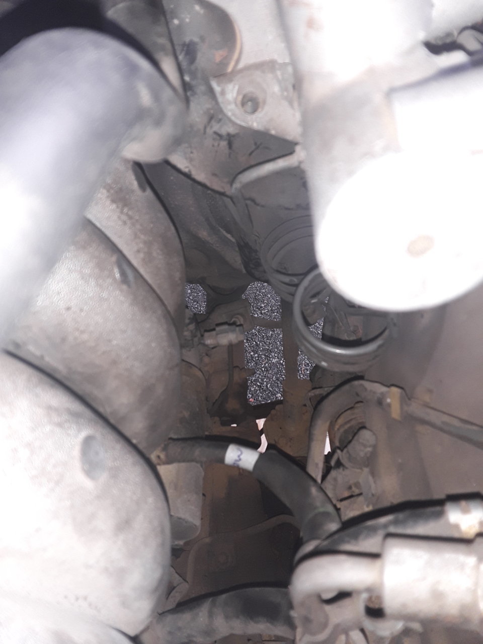

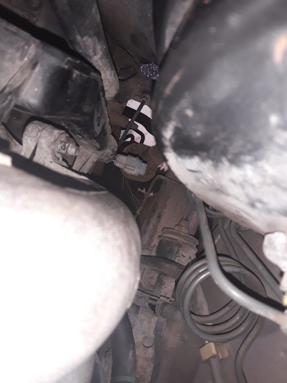

    Does anyone know what this plug is? I don't remember taking it off but there's like nothing or nowhere to plug it in at? It's on the backside of the intake manifold20190715_191101.jpg 20190715_190955.jpg

    Jul 30, 2017

    Looks like its got a factory cap on it. I have one or two of those in my engine bay as well. wouldn't suspect that to be the problem if it's capped.
