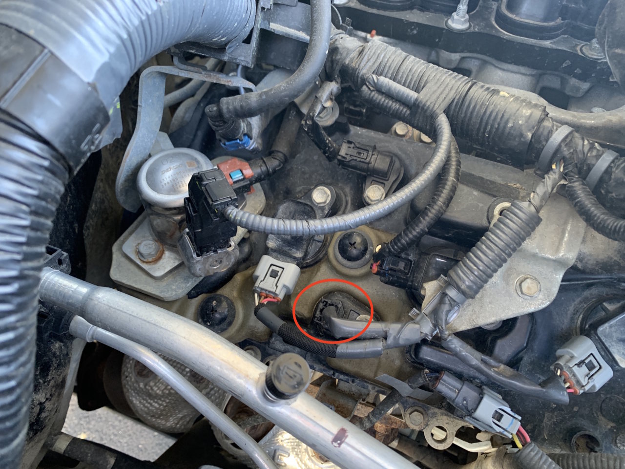

    Changed the spark plugs this morning as part of my 60K maintenance. When I was all finished, went to start the truck and it wouldn't start, was just turning over. I pushed the button to stop it. Pushed it again and the truck started right up, but the check engine light is one and the TRAC light too. OBD scanner says code p0368 "camshaft position sensor B." Obviously related to something I did. I am going to check all connections now. Does anyone know which sensor is B? Any other ideas on a cause or fix?

    Void. Fixed my own problem. In my haste I missed a connection on the passenger side. Clicked it in, started up, and code cleared itself. Guess haste makes waste...

    A reply with a pic to show exactly what you did wrong?!
    Out-freakin-standing. That's good stuff, that will save someone's tail one day.
