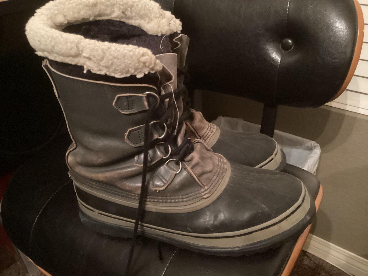

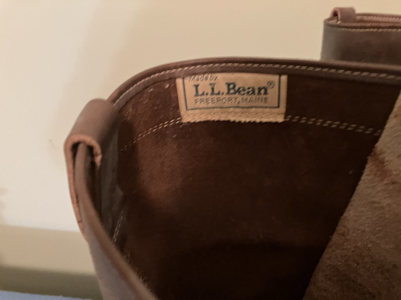

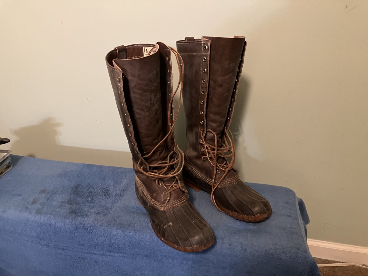

    I brief right turn:
    Growing up in NE Ohio in the 60's and 70's (yes I'm old) we called all winter boots Sorels because that's all the hunters and ice fishermen bought and wore. Maybe an occasional L.L. Bean Maine hunting boot but for warmth it was Sorels.
    These MHBs are probably 40+ yo. I still wear them in muck. Point well made on planned obsolescence.
    Now back to Tacoma stuff.
