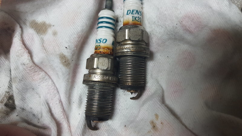

    Made a lot of hard spots, then "popped" free, throughout the removal, eh? A friend's did that to me. Thought I broke the ratchet, or the plug.
    You added antiseize to the new plugs, correct?

    Yes.
    Drivers side had resistance all the way out, had a noticeable more baked in crud on the threads. I presume maybe from the pvc system.

    At least inspect them. Slap some antiseize on them, and they'll be a delight to remove in the future.
    The Denso Iridium tip plugs were designed to last 100k. All things being in optimal condition.

    The over tightening for sure. I feel for the crush washer crushing. 30 ft-lbs non lunricated, is a lower torque number for lubricated. Thus their comment about over tightening.
    However, had even the slightest amount have been applied to the threads prior to install, those thousands of heat cycles of the years to equate to 130k, would certianly help them remove easier. Without the fear of breaking them.
    It is all about moderation. It might sound perfect on the paper, but I guarantee that it is better to have than not.
    Those that have never had to deal with a broken spark plug because of the threads being seized, will never know. Or an exhaust sensor, or other exhaust hardware, due to no antiseize. A little goes a long way.
