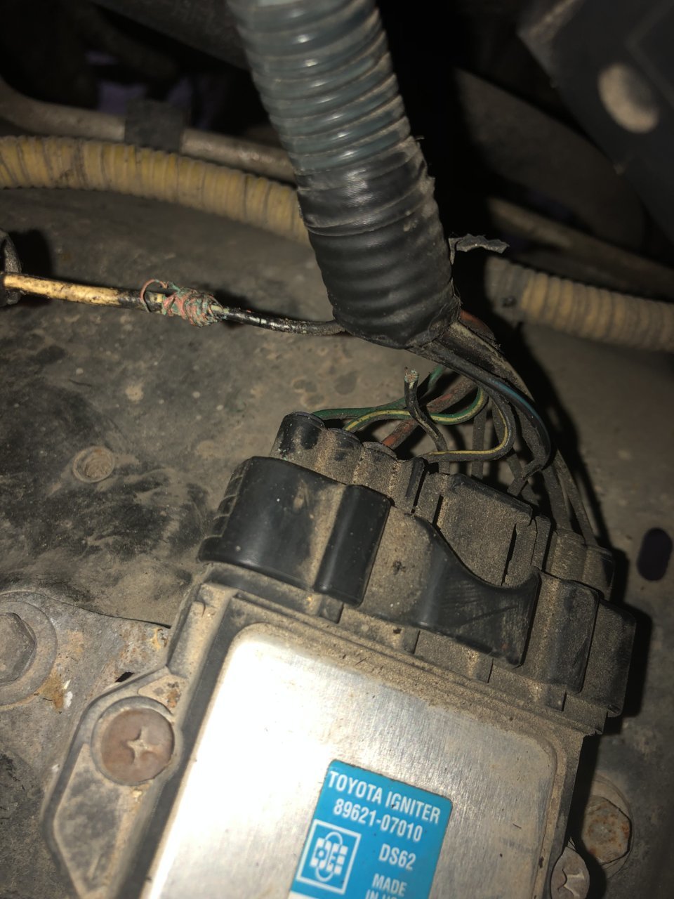

    Went to take a pic at my igniter and this. Anyone know what may be going on here? I do know that my truck has an aftermarket remote start maybe this yellow wire could be that. Beats the hell out of me

    I know if my autostart does not sense my truck started the starter gives up, and it senses this by a wire which if my memory serves me right is yellow and in the engine bay somewhere...not sure if that would shut the truck off while running though but who knows

    Someone cut that wire and connected it to the other wire. I was going to ask about any security systems you have. Maybe you have a kill switch somewhere. Try to trace that wire and see where it goes. Maybe someone can look up what that wire is for from that pin in the igniter.

    Looks like pin 5. That wire is supposed to go to the ecu. Pin IGT3. Which is the ecu input for the Ignition timing output to Igniter for coil pack #3.

    If the ECU doesn't receive the signal back that the coil fired repeatedly then the ECU cuts the injectors. This other wire must be tricking the ECU somehow, and now stopped doing whatever it was rigged to do.

    So that black wire near the connector broke away from the yellow wire with the bad connection/corroded, so just re attach so all three wires are connected again if that makes sense....whoever did the autostart install did a poor connection that corroded, you might have just given it that little final nudge to break it apart. The yellow wire is what the auto start uses to see the pulse to know the engine is running thats why they tapped into there.
