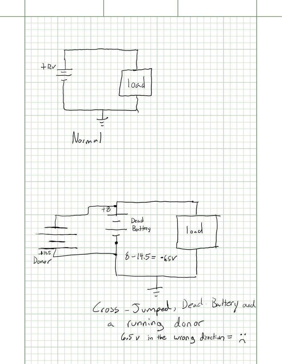

    Its not hard to add reverse polarity protection to some circuits, and automotive circuits are tested for all kind of random stuff ( a fun one is the alternator load dump) But I doubt Toyota would see it as being worth the trouble since this is such an uncommon case.
    Is cross jumping with 2 batteries involved going to be different than reverse polarity with a single battery? Seems like you'd have a potential for +24V with 2 batteries.

    No your shorting the batteries against themselves.

    Yeah you're right, i had to draw a picture. The deader the battery, the worse it is.

    Plus the doner car will not like it at all too if you even get close to clamping that last cable.
    Arc welding 101.
