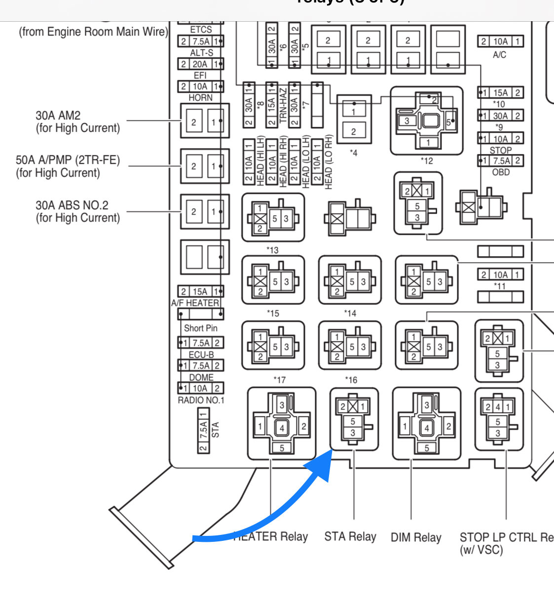

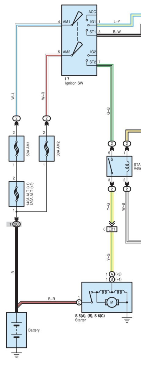

    You can check pins 1 and 5 of the STA Relay. You HAVE TO BE CRANKING THE ENGINE to check it.
    This will help diagnose the problem.
    I’m betting pin 1 is the problem.
    If Pin 5 also has no power, we got other problems. And it isn’t the PNS switch.
    CF6D737C-2F9F-4C16-A5D2-AFA32BAFA2CA.jpg 684385B8-B923-4905-8803-9A80BB20D32B.jpg
