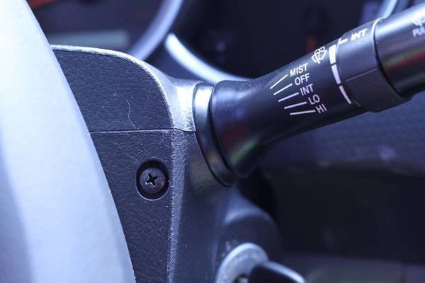

    Turn the wheel to the left and remove the phillips head screw located at the bottom of the turn signal.

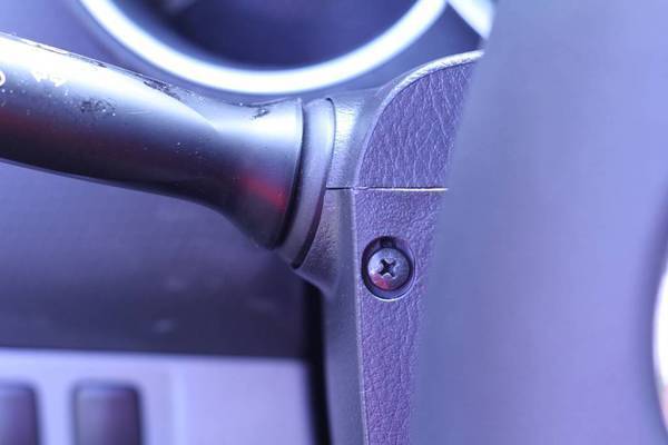

    Turn the wheel to the right and remove the phillips head screw located at the bottom of the wiper switch.

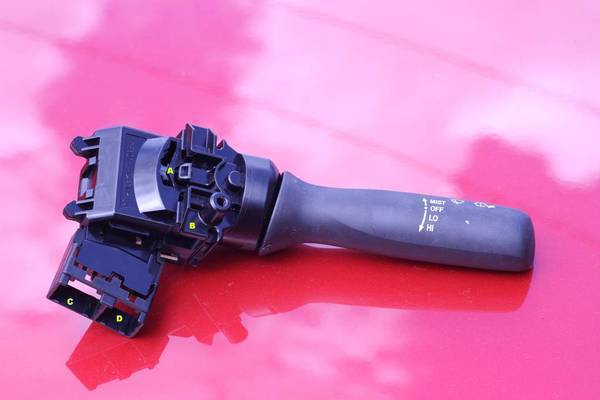

    Once the shield is removed you will need put the key in again and crank the wheel to the right. The easiest way is to press in on the release tabs on the wiring (Marked C & D on the above wiring) and gently pull the wires to one side. Unlock the latch at the point marked B. This should release enough tension to keep it from relatching. Finally you will need to take a screw driver and press in on the latch marked A. This is the reason you need to crank the wheel to the right as I had a bear of a time trying to reach it any other way. Once the latch is release you can remove the old switch.
    Installing the new switch is just the reverse process. Pushing the switch in will lock the latch marked A. You will need to press the switch in and manually engage the latch marked B. With the harnesses going into C & D being sized differently it is easy to get things rewired quickly and correctly.
