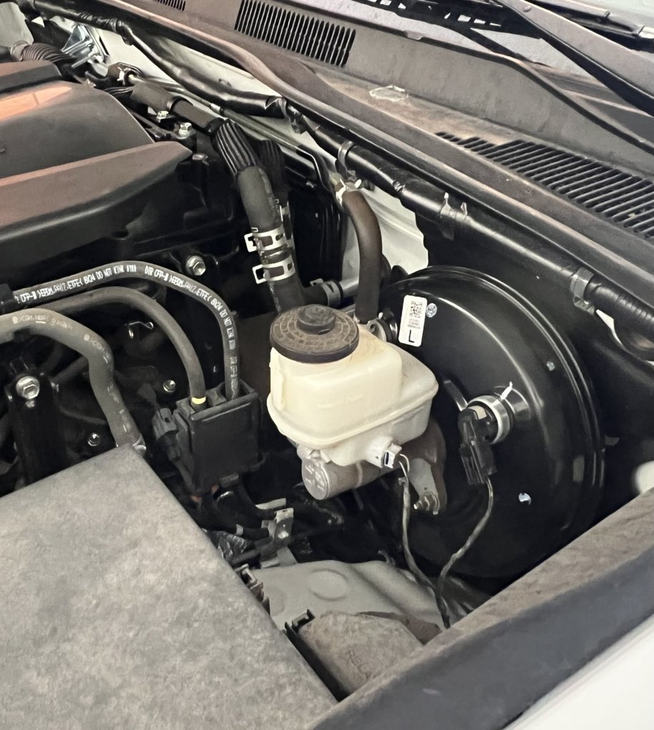

    I have a ‘19 TRD Off-Road 4x2 and I was wondering if changing the brake fluid is a simple as draining the master cylinder, adding new fluid and then going to each wheel and flushing the fluid out while someone presses the brakes and another person opens and closes the bleeder valves?
    This is how I’ve done it in the past but apparently it’s different for the TRD off-roads? I’m no mechanic and I’m learning to do my fluids on the truck to save money. Thank you!

    do the 2wd ORs not have the electric/hydraulic booster? the pic you posted shows a normal vacuum booster

    That was part of the reason I was asking was because the video that got posted his reservoir looks different than mine in the beginning when he mentions the TRD off-roads and pro models
