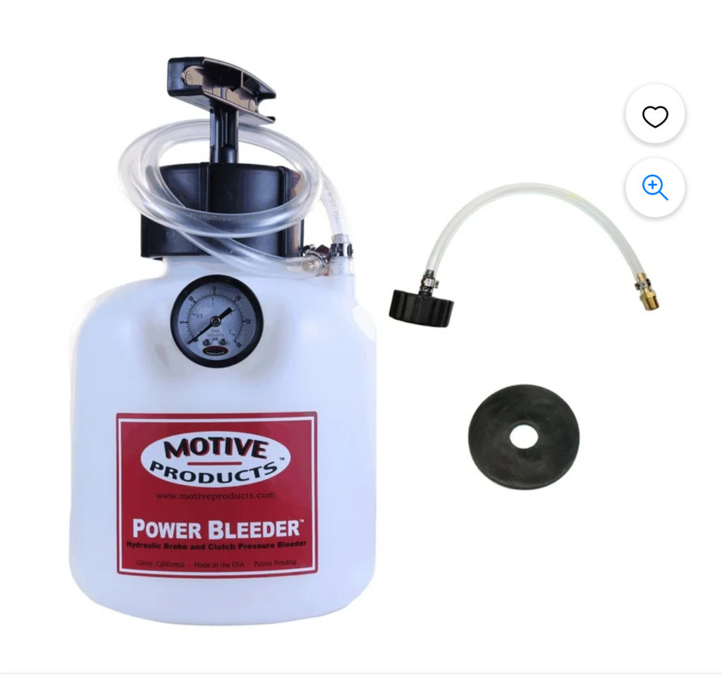

    Something like this?

    YES, ensure you get a Toyota cap and don't over pressure the system. I usually pressurize about 5-8 psi.

    I have a Motiv pressure bleeder, and it is OK. I had a terrible time getting all the hose fittings to stop leaking. Once I used different hose clamps, it was better. I like it because I can see the level of the fluid in the tank.
