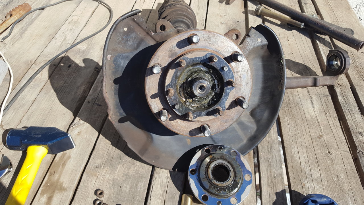

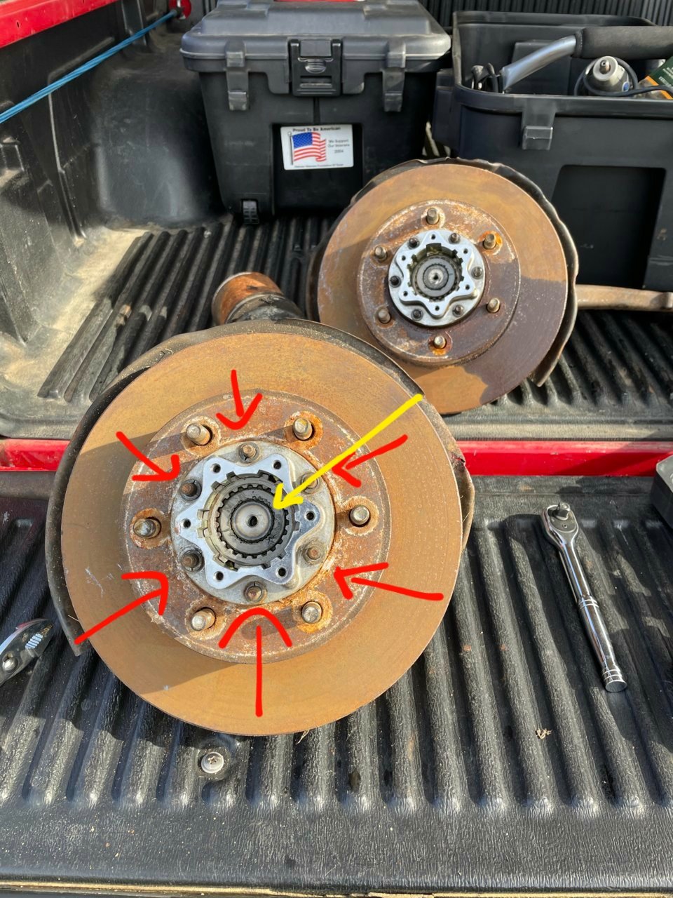

    Posted it tons of times...
    The bolts on each of the red studs need to be placed back on, flush with the stud.
    Rest a brass drift on the stud/bolt.
    Whack the end of the drift with 2 or 3 solid whacks, and the cone washer at the base of the hub body will pop up.
    Do so for each one, and once all removed, hub body will come up and out.
    At that point, more of the axle shaft will be exposed.
    There is a snap ring, depicted by the yellow arrow, on the axle that keeps it from backing out of the spindle.
    Remove the snap ring, and the spindle will slide up and off the cv axle.
    May as well rebuild your hub while you have it off.

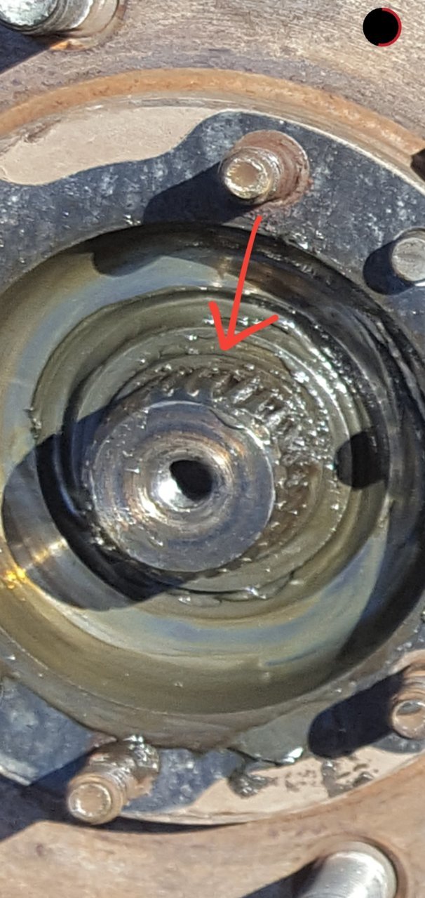

    Here's a pic of the manual hub body off my last set; you'll see the snap ring under the grease -

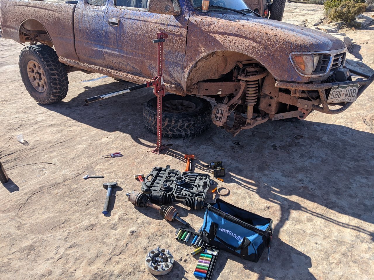

    Actually I lied sorry :/ is the easiest way to get the cv out while on a trail would be pop tie rod and upper ball joint ?
  13. Dec 31, 2020 at 7:21 PM
    Kwikvette
    Feb 27, 2019
    #284735
    82,962
    Fresno County
    4 run, 2 don't
    Lower ball joint; I was able to replace my cv axle just by undoing the 4 bolts on the spindle and lbj. The spindle will swivel out of the way if you man handle it.
    Just be careful with your brake line.

    I just pop the lower ball joint or undo the 4 bolts, either way, tie rod and upper can stay

    I believe you can leave the hub bodies on after pulling the dial face and internal components.
    I usually carry a brass drift because it's easier to pull the body to get the snap ring off.

    Disconnect the lower ball joint.
