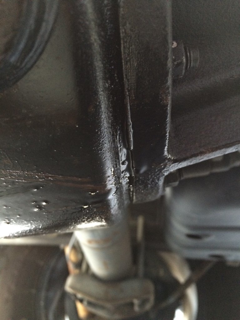

    Just saw my rear diff case is leaking...Guess it is time to replace this weekend. Does the drain plug for the diff case need a gasket similar to the oil pan gasket?

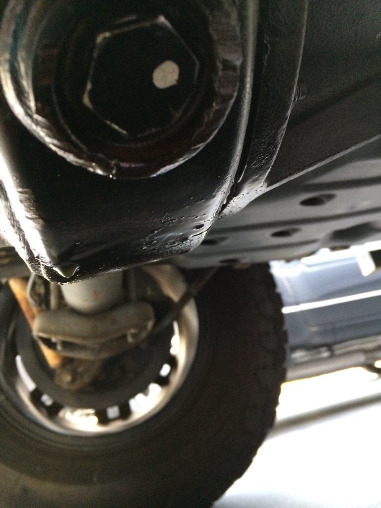

    Changed the fluid last night, and went out to this am. Turns out the leak is coming from the rear differential case to housing gasket. It's where the housing meets the case and there are 12 or so bolts. Anybody have this issue?

    Sometimes those bolts will loosen up and need snugging back down. Clean the area with brake parts cleaner and see if it starts leaking again.

    Was able to tighten the bottom 4 bolts. I'll monitor it tonight. Called the stealership to ask about replacing that seal. Dude gave me a quote of $1000 over the phone. I couldn't help but laugh.

    My first gen did the same thing, cleaned it good and never leaked again after I tightened.

    Has anyone changed this gasket/seal before?

    Have you tried re-torquing the bolts holding the diff together? could just be loose.

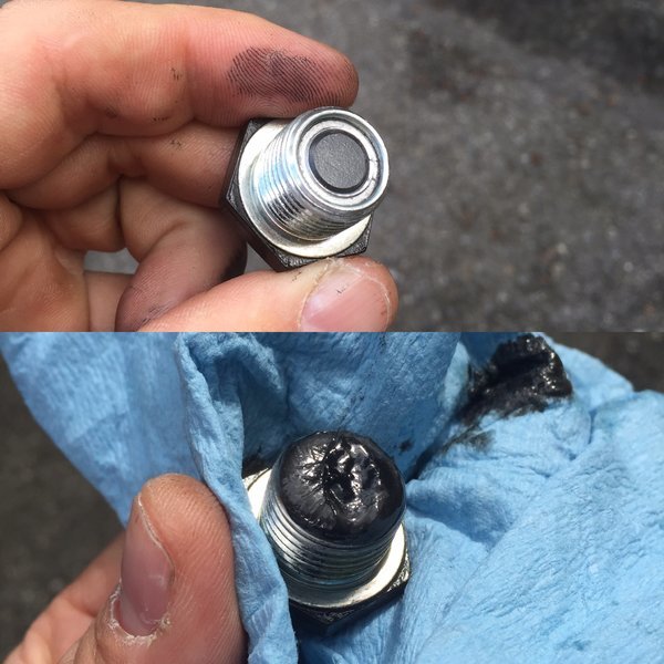

    18,500kms rear dif change. Fluid came out with a grey hue. Magnet had a solid layer of material on it. Adding Amsoil severe gear 75-90.
    Mechanic I bought it from said I should be good for life with this change.. Opinions? image.jpg

    Good for life... ummm NO!!! Change at least every 30k miles

    I figured as much, ended up doing T-case and both difs, it was actually a pleasure and I saved hundreds no doubt. I'll do it again at 50k, cheers
