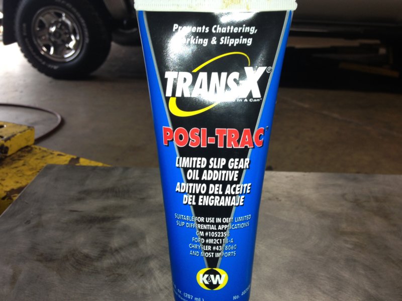

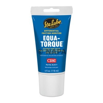

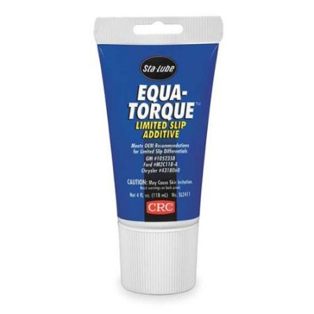

    Hello folks,
    I did the last diff fluid change 16,000 miles ago. I have an '08 Prerunner SR5 but I bought a new LS diff from Toyota about 60,000 miles ago. I used this friction modifier on my 3 diff flushes done so far it is a 7 oz bottle & I have to be careful not to add more than the 4 ozs. Part #402508 pictured below:
    Also thanks to @chris4x4 , @brianr , @Demoncleaner , @MonkeyProof for their post & help with questions I had.
    Or can I use this one which is available at my local NAPA store and is a 4 oz bottle:
    Or this one available at Walmart that is also in a 4 oz bottle:
    Is there a significant difference between either one of these or is ANY friction modifier good enough? Sorry if the question seems silly but I paid $1439 for that diff so I want to add the right stuff in there & I don't want to add TOO MUCH friction modifier so that's why I'd rather get the 4 oz bottle.

    If you add 7 oz., it wont hurt anything. Any of those will work fine.

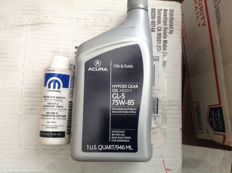

    This is what I have at home so this is what Im gonna used for my 06 TRD Sport edition. What you guy think!!!

    You don't need the LSD additive. Here's how it breaks down.
    2005 - 2008 Tacoma Sports Diffs have clutches in the diff which require the additive to be added along with the Gear Oil.
    2009 - 2015 Tacoma Sports have electronically controlled LS diffs. Basically it is an open diff. What makes the Limited Slip "effect" is the brakes. When one of the wheels starts to spin the computer applies the brakes to that particular wheel, creating a similar effect to Limited Slip. If you wheel a lot you may wear your rear brake shoes faster than the front brake pads.
