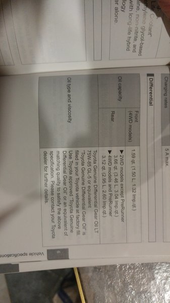

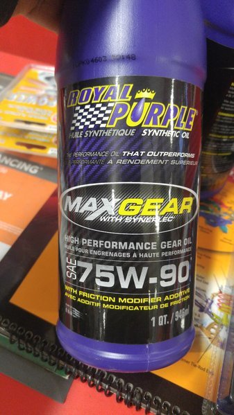

    Can I get a straight up reply.... Is this safe to use front and rear... 09 trd sport 20170116_165406.jpg

    Well I hope you do get a straight reply, but do you have your user manual? That's how I figured out which is best for my rear differential.

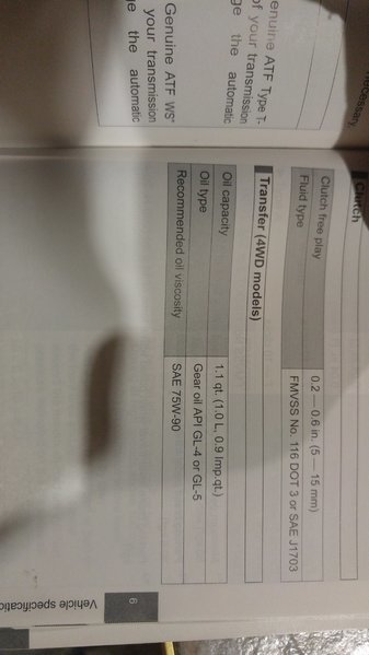

    Yes, that will work great, I used Mobil 1 75w90 on both Diffs, and Transfer Case, she runs great. It's about as clear as mud trying to figure out with oil to use, but that Royal Purple 75w90 will be perfect, the other option is you can stop a Toyota Stealership, and buy the very same oil filled at production of your truck from the parts guy, that is, if you feel so inclined.
