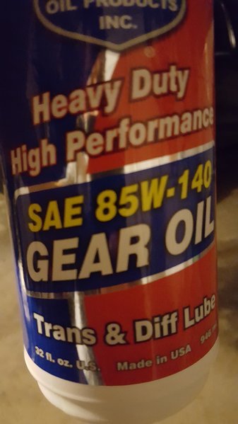

  15. Mar 9, 2017 at 7:41 PM
    #2215
    2015WhiteOR
    2015WhiteOR Well-Known Member
    Feb 2, 2015
    #147773
    1,903
    Gainesville TX
    Way too thick. It'll work but it'll cause a lot of drag. My old F150 with a Ford 8.8 used that stuff.
    Norton and Rakso[QUOTED] like this.
  16. Mar 9, 2017 at 8:10 PM
    #2216
    Rakso
    Rakso CeRaTi
    Feb 26, 2009
    #14105
    9,665
    OsKaR
    Cali
    09 PreRunner
    LSK LT in Progress, custom bed cage, DMZ SUA kit with 2.5 kings triple bypass, kings bump stops, baja bumper, rear custom tube bumper, glass all around, Weather Tech Liners, wet okole seat covers, Cluster LED Swap, HU LED Swap, hood LEDs, bed LEDs, etc etc etc
    I know, thats what is recommended for my 4.56s gears though.

    Yup, East Coast Gear Supply builds diffs for a living and swears by it. The worst they said, is Royal Purple.
