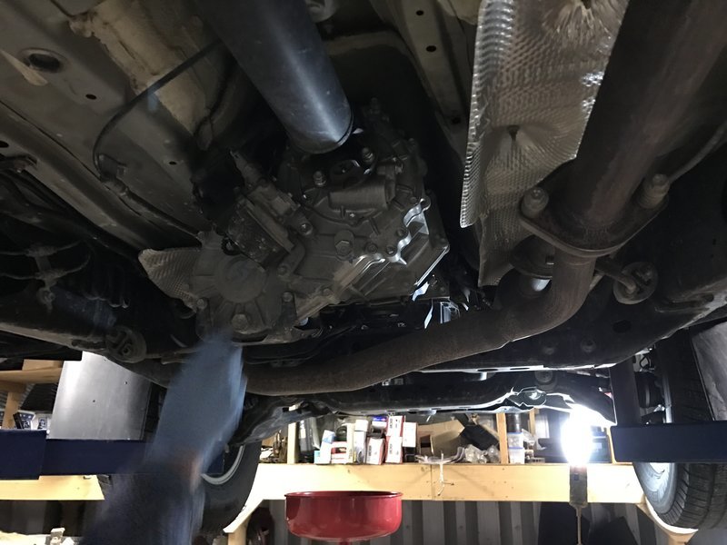

    Nice to have a friend with a lift....made this job a LOT easier!!
