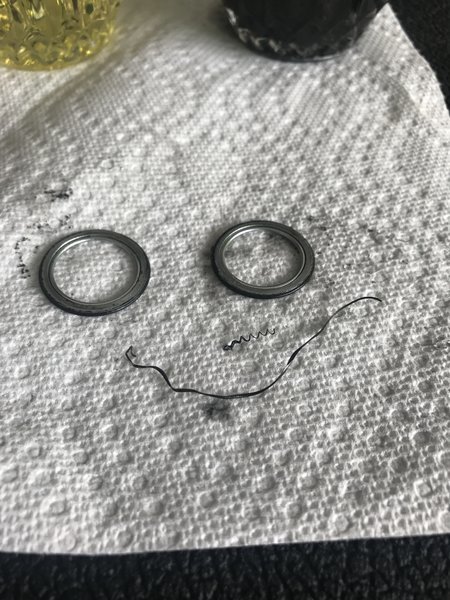

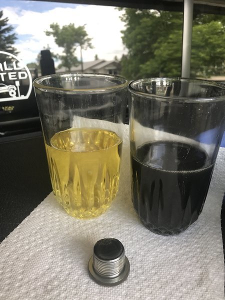

    Just changed out my fluids for the first time (13,000kms). Anyone ever notice big strips of metal come out?

    Tiny bits and shavings are normal, the drain plug usually has a magnet connected to it that catches them. But those are bigger metal shavings than I've ever seen......don't want to say that's bad but that might be bad lol. Someone with more experience than me will have to chime in, I've done mine a few times now on my 04 and all I ever get are little tiny pieces that you can hardly detect.

    They're drill shavings... as long as they were on the magnet, I wouldn't worry about them

    The magnets has a thick layer of fine metal sludge on em. 13,000km doesn't seem like much but it's been in the mountains since day 1.
