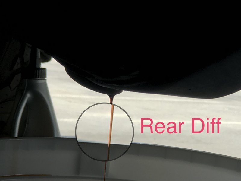

    Just finished the rear diff, this stuff stinks! Like oil and BO, magnet had a bunch of sludge on it.

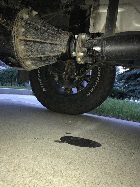

    So I did my fluids last week and noticed a leak from the rear diff seal for the drive shaft. Truck is still new 13,000km and this was the first gear oil change I did. I'm not sure how I could have messed up. I used Mobil 75-90 as per what the dealer recommended... any thoughts?

    I think it's coincidental. Looks like a warranty claim

    Just got a call back from the dealer, they said they couldn't find any leak. :facepalm:
    Even the shop foreman checked it he said.. wtf!
    You can see the oil stain around that area it's not that hard to miss. They're checking it again...

    Did you show them this picture?

    He just called back and said "it's definitely leaking". Well duh!

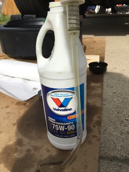

    Ordered the double-pack of cheap pumps from Amazon ... and found that the tube to draw from the bottle wasn't long enough. Ended up using some of the flexible tubing from the second pump to extend the draw tube to the bottom of the bottle, as below:
    As delivered, the pump would only pull .75 qt from the bottle, leaving me to transfer the leftovers to another bottle.
    Link: https://www.amazon.com/gp/product/B01LDMXNSO/ref=oh_aui_detailpage_o00_s00?ie=UTF8&psc=1
    To note, the draw tube was not flexible as shown on the amazon photo.

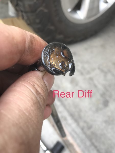

    Thanks brian! Did it for the first time in 145k :crazy:. There were a couple shavings but hey, it was 145k. There was the muck like others that had posted pics of the magnet but the pic I provided was showing just the metal.
