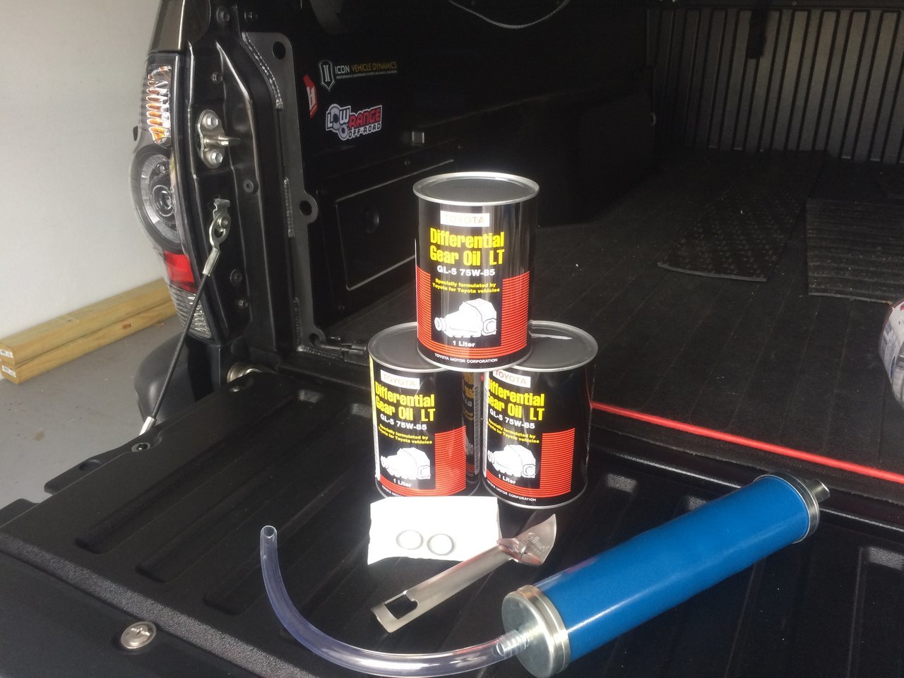

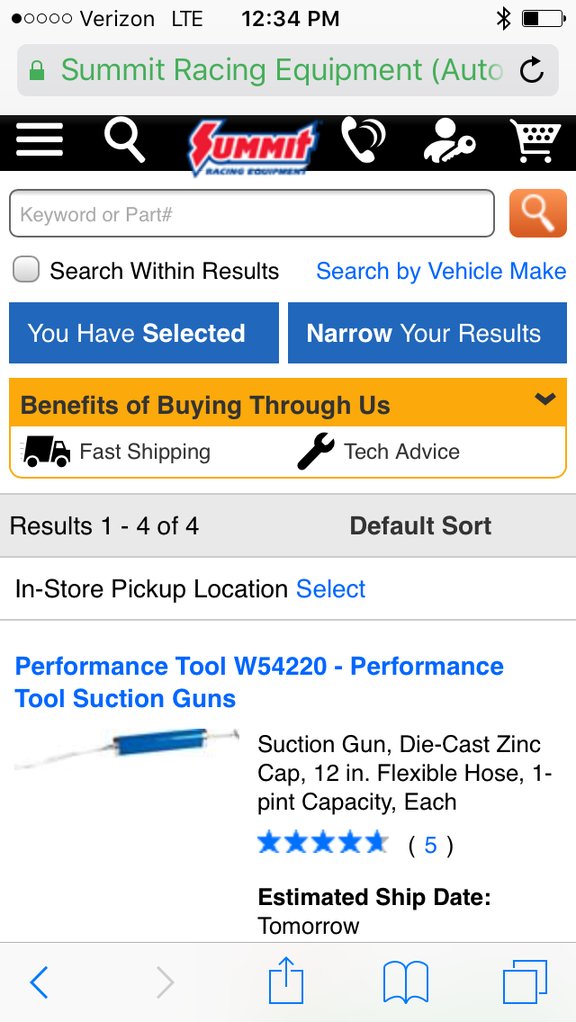

    What pump is this?
    Soul Surfer[QUOTED] likes this.

    It's a Suction Gun, I purchased it from Summit Racing. It worked Great with canned fluid.
    Johnjaz[QUOTED] likes this.
