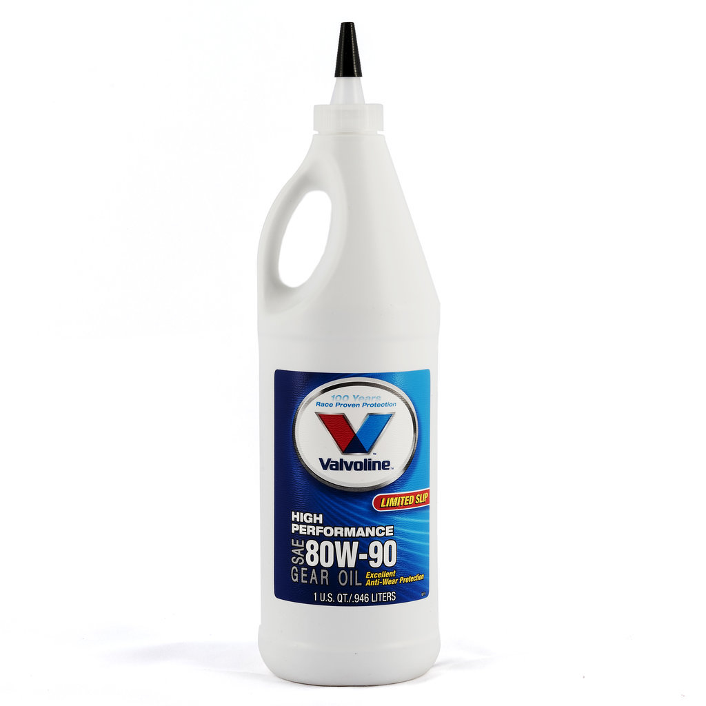

    Can someone confirm if this can be used for the rear diff?

    That's what I have in mine :thumbsup:

    did you use any addition additives or anything else? did you use the same for the front diff and transfer case too?
