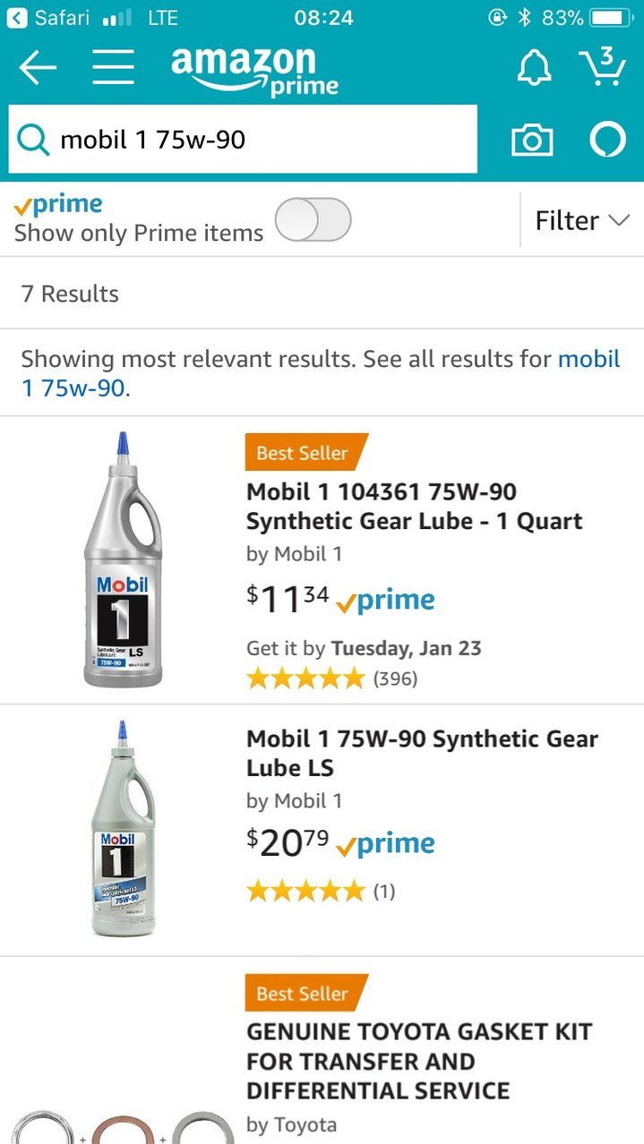

    So I found the gaskets on Amazon (Prime)
    ..heard from other TW members also that even if you don't need LS (Off Road models) you can use oil that has the LS additive, however if you need the LS additive (Sport models), you cannot go without it
    Also is the difference between 85 and 90 reason enough to not just order 6 quarts of the Mobil 1 104361 75w-90 Synthetic Gear Lube for $11.34 and change both differentials and the transfer case?

    Gonna be using the Mobil 1 75w-90 with LS (even though TRD models don't need it) but it's a hell of a lot cheaper than others.

    For 2015, I think none of them need LS. Also, in that pic, isn’t the LS listed for more?

    It is, I stand corrected. :anonymous:
    Anywaaaaaaaaays......
    From what I've read, if you have the TRD Sport model then you need LS additive
    If you have the TRD Off-Road model then you do not need LS additive
