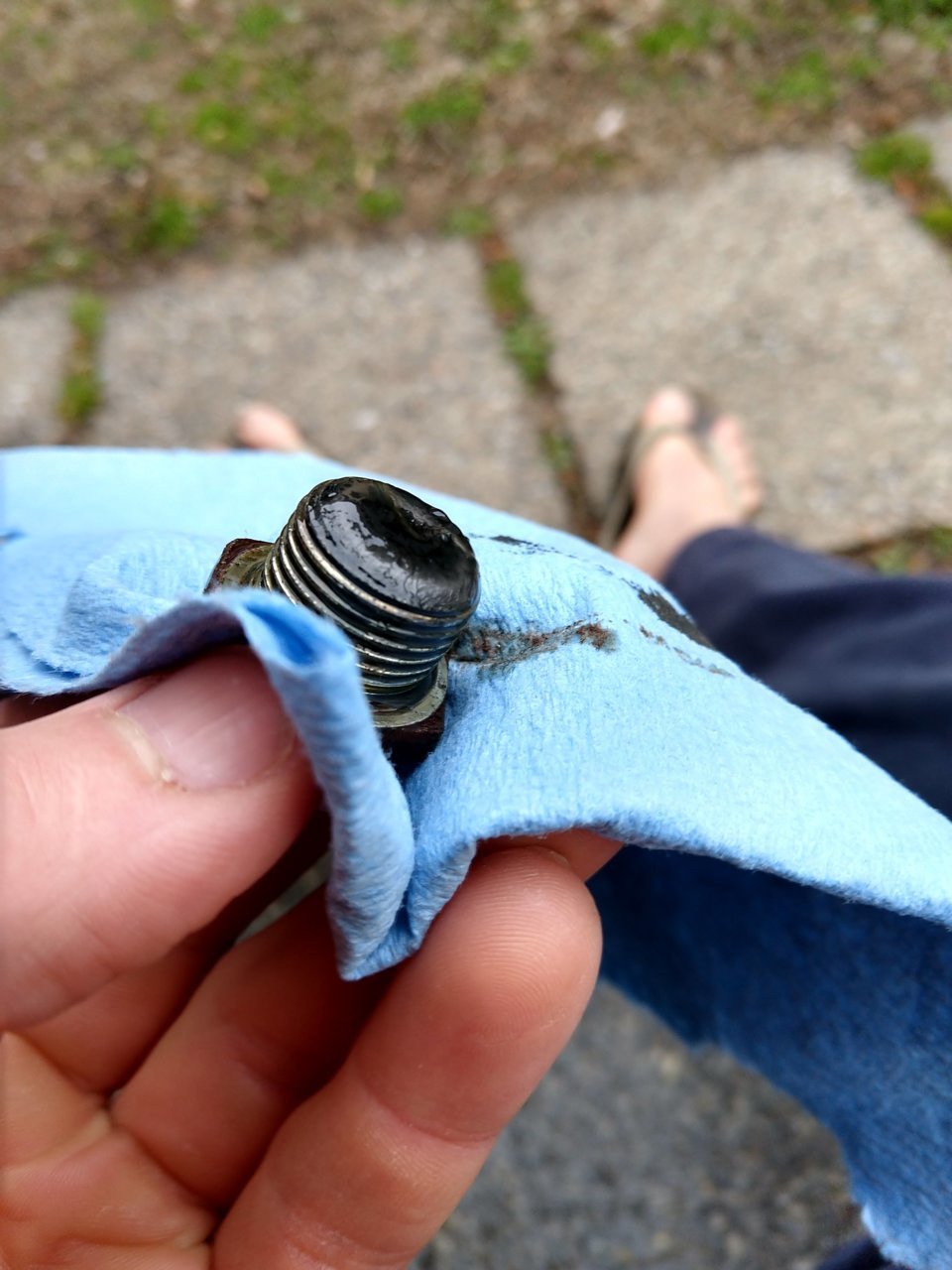

    Thanks for a great write-up! I did this just now. Pumping with a handpump was the hardest part, wedged as I was underneath the rear tire and with the hand pump moving so little volume at a time (use the same one for my 6 hp outboard, which needs less than a quart).
    What worked best for me was the blowtorch/ice trick (torch the bolt and surrounding area of the housing, shut off torch and spray liquid wrench or similar, then apply ice to the head of the bolt) to unstick the differential fill/drain bolts. One other observation was that, working on the differential from the rear of the truck, the rotation for the drain bolt was the reverse of what I thought it would be: I watched this video to figure out which way to rotate the bolt (after I unstuck it in the wrong direction).

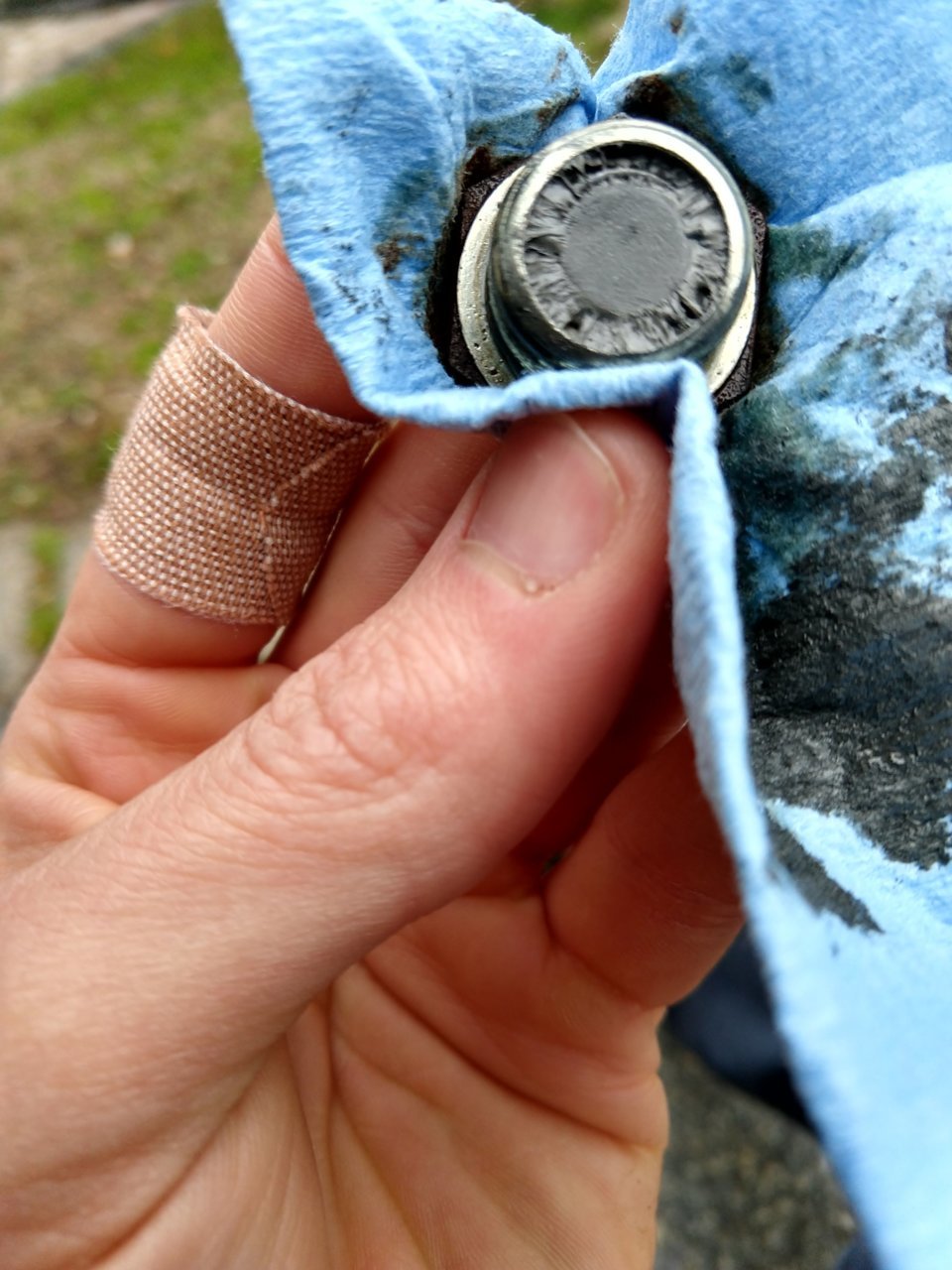

    Also - I'm kind of bringing an old 1998 pre-runner back from more than a few years and tens of thousands of miles of differed maintenance. How close do you think I am to needing a new differential based on all the sludge on the magnetic bolt? It's not just bad oil - all of the sludge between the magnet and the bolt interior wall was metal, and all the sludge I wiped off had that metallic glimmer to it.
