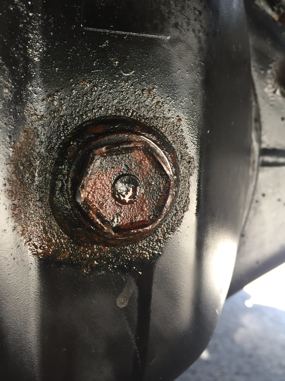

    Went to go do this today just for shits 'n giggles. I'm a little over 90k (bought the truck w/ 82k) and either the diff oil has never been changed or NH salt seized the bitch on pretty damn good. Doused the plugs w/ wd40 before work this morning and then a little more while setting up shit when I got home...plug would not budge and the socket definitely started to bite into the plug. Soaked it down again and the plan is to let it sit and spray it again before work tomorrow and go at it tomorrow afternoon. If the socket is already biting at the plug should I worry about stripping it completely and be ready for a new plug or should I just keep cranking til it breaks free... Posted a pic just to show the socket biting at a couple corners of the plug...drain plug doesn't look as badIMG_3832.jpg

    So pretty sure my issues were just a rookie mistake...Realized a 12-pt socket was a terrible idea (24mm is maybe the only socket I own that I didn't have a 6pt). Got a fresh 6pt socket and some liquid wrench today and the plugs broke free without much issue. Learned my lesson that WD40 is essentially water compared to LW...Everything was straight forward for a 2012...used about 3.5 qts of 75-90 M1, no additive needed because I actually read the post from the OP, put new washers on, torqued her up, let it sit while I cleaned up, drove a bit, sat, and was on my way. Hardest part of the whole thing was smoking my elbow off the ground when the fill plug broke free and then hand pumping that shyte in there.

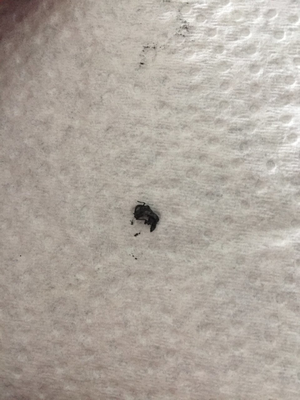

    One question I do have though, I'm posting a picture of a shaving that came off on the magnet, apart from the normal sludge that appears to come out on the magnet I'm wondering if I should be worried at all or if this is just commonplace for what appears to be the first maaaaaybe 2nd diff oil change on a 90k/6yo truck (truck was bought in 2017 with 82k on it)
