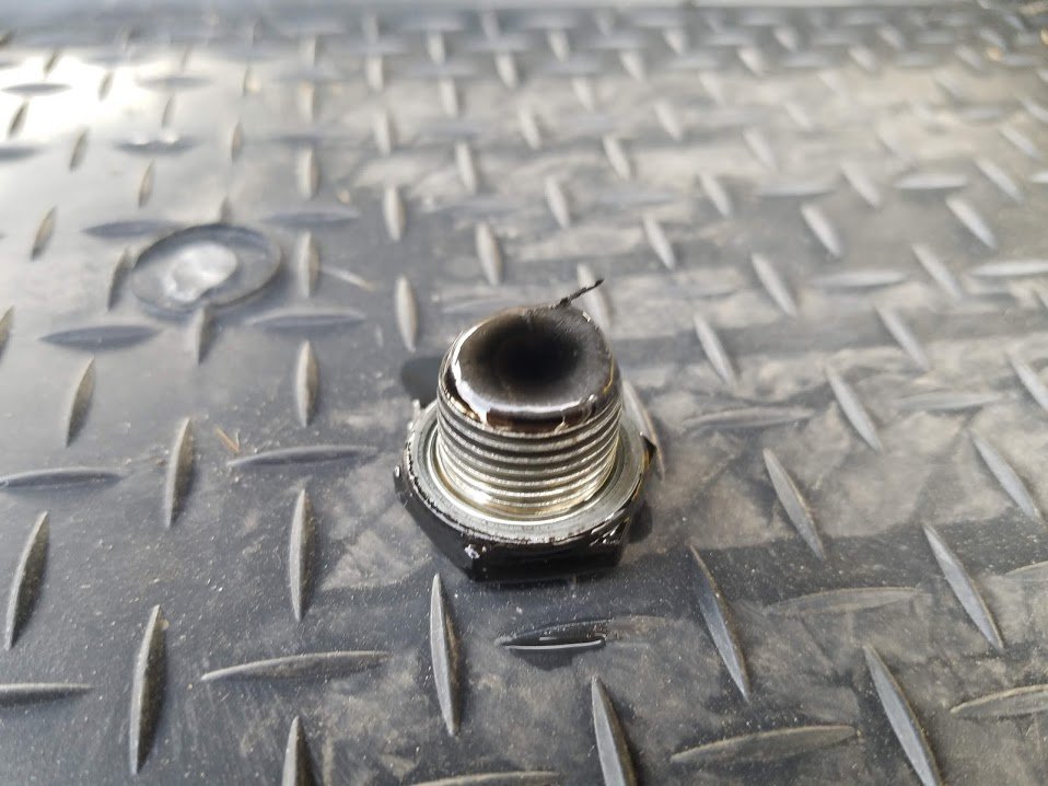

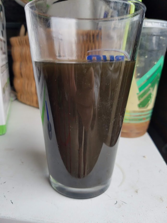

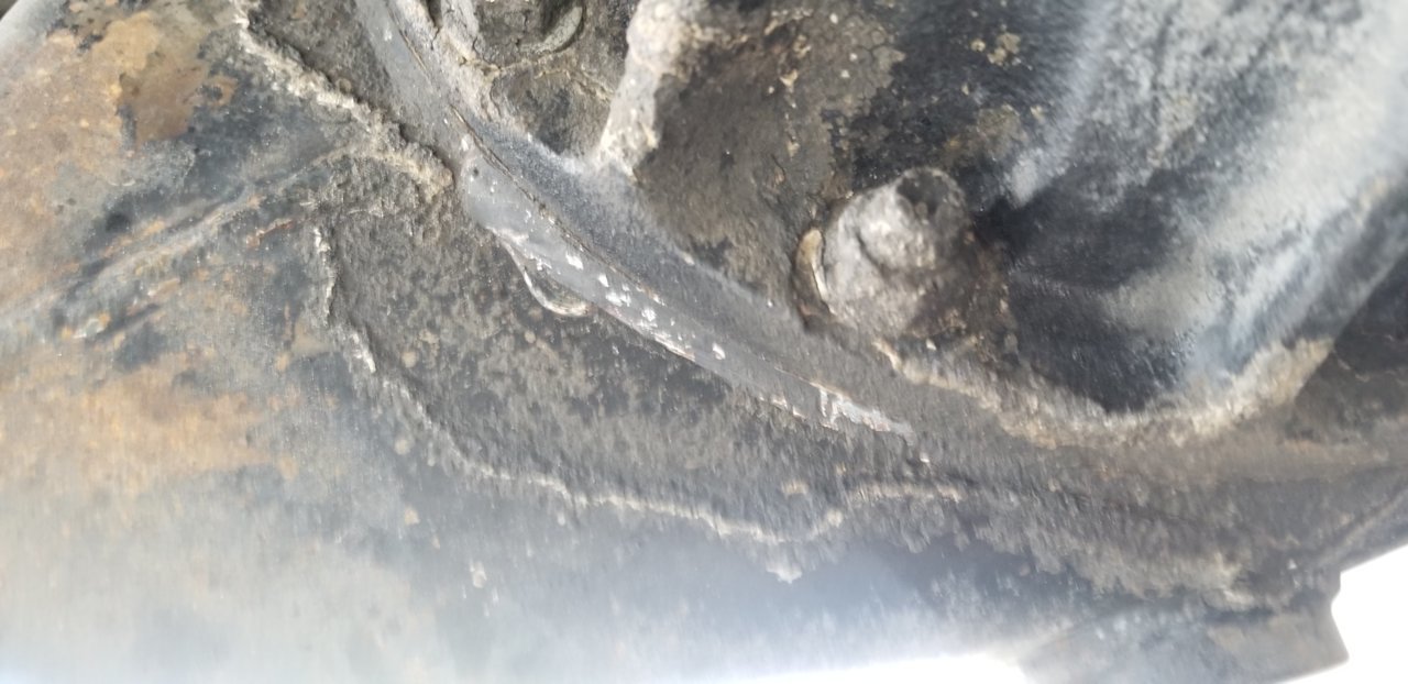

    Just finished up with the front/rear diff and xcase.. Not that hard.. good write up thank you!! I was fulling expecting to see at least one metal flake in there some where and all I saw on the magnet was "goop"..

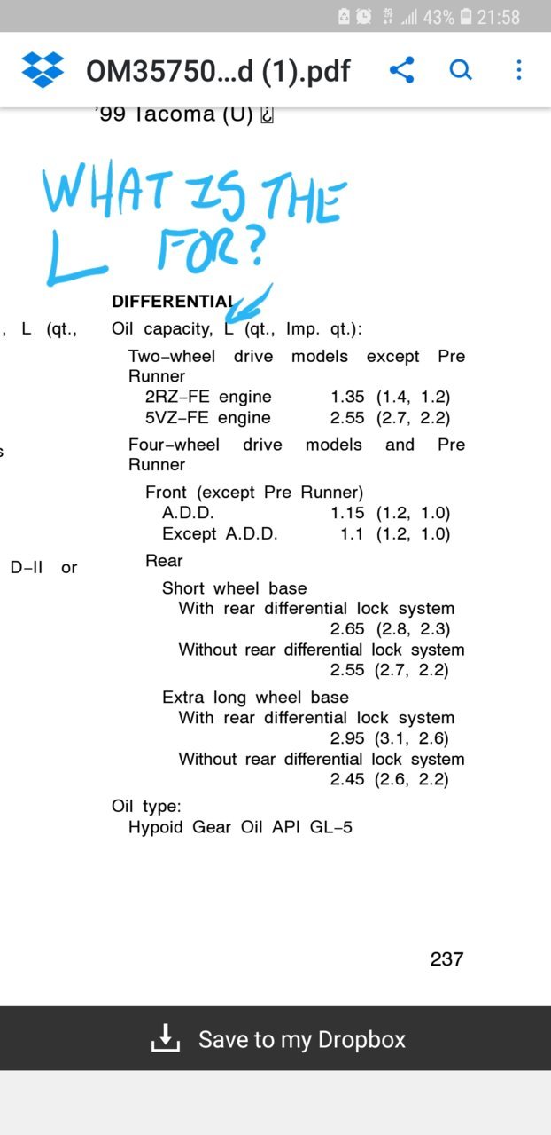

    According to pp 237-238 of your Owner's Manual, your Front and Rear Diffs both call for 80W-90 Hypoid Gear Oil API GL−5. LSD additive is not required.

    Thanks but when I jack the rear up and turned the wheel they went opposite direction. Is that what lsd is used for? I dont know .just got a 1999 Tacoma v6 3.4. L 2 wheel drive

    Do you know where to download the service manual Norton?

    Maybe I didn't understand your original question correctly. I though you wanted to know whether you need to put LSD additive (aka friction modifier) in your Rear Diff, not what the purpose of an LSD is. @Yota_Ivan kindly answered the latter question. Your Owner's Manual does NOT specify LSD additive for your truck. FWIW, it's not specified for my son's '01, wasn't specified for my '04, and isn't specified for my '13, so the answer has been pretty consistent.

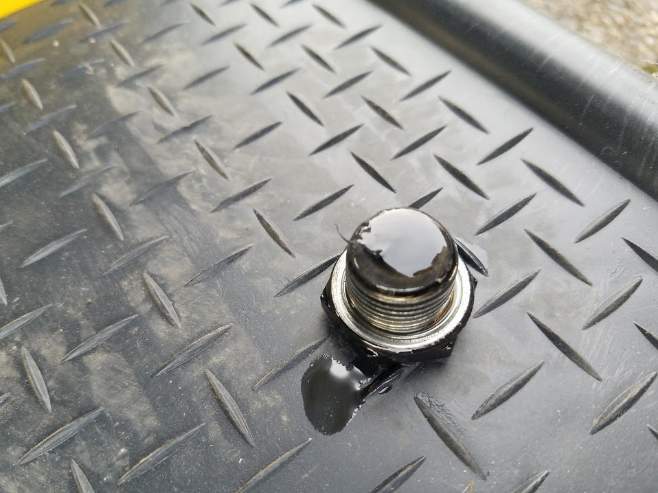

    Changed out the gear oil with 60K miles on the clock... the rear diff plug had a few specs of debris adhered to it and the oil wasn't all the bad (dark but no water evident/no burnt smell). Transfer case gear oil looked like new and the front diff gear oil was similar to the rear. A few squirts of Liquid Wrench a few days ago on the fittings, a 6 PT 24mm socket, a T55 star bit and new washers made the job go very quickly.
    I went with AMSOIL's "Easy Pak" in 75w90 for the 3 diffs. No pump needed as the "EasyPak" container is a like a kid's squeezable juice box.
    No fuss, no muss, no spills, no waste AND NO MESS!!! Total job took including "clean up and put away" took about 1.25hrs.
