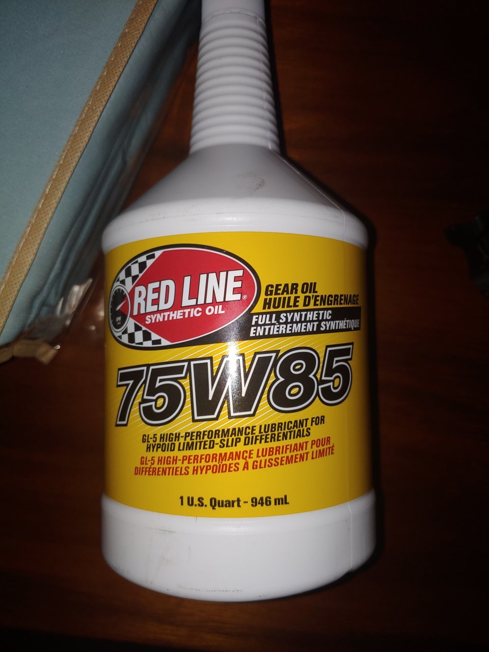

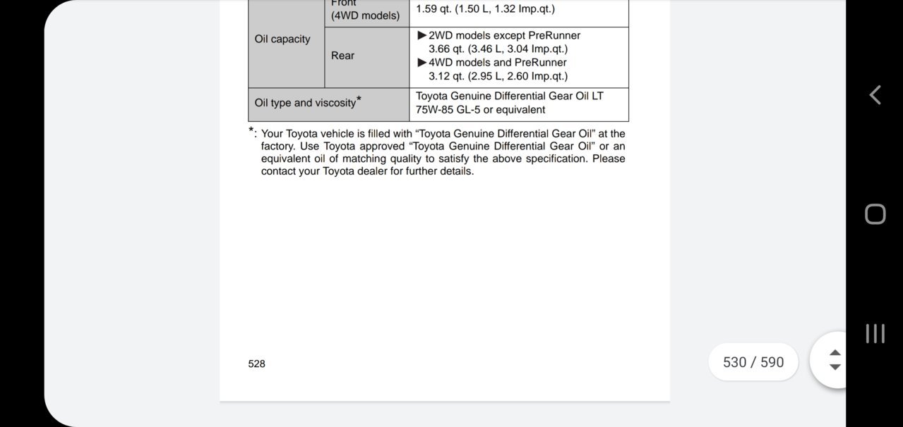

    Thats what I got. The quart bottles suck with fluid transfer pumps so I would go with the gallon jugs. I know people recommend this and at least my truck calls for 75w85 gl5 which is what you have and redline website suggests that

    I was just concerned about the front saying "hypoid limited slip differentials." i thought tacomas didn't have limited slip?

    I think toyota stopped LSD in 2009 roughly but I don't think it'll hurt our trucks. Mine is good so far. Maybe someone else can chime in. Im sure its been covered in this thread several times. Can search through thread if no one else will chime in

    +1. I don't recall the exact timing, but that sounds about right. In my experience, there's no harm in using LSD-compatible lubricant in non-LSD applications. The reverse, however, is not always true - LSDs require the friction modifier to work correctly.
