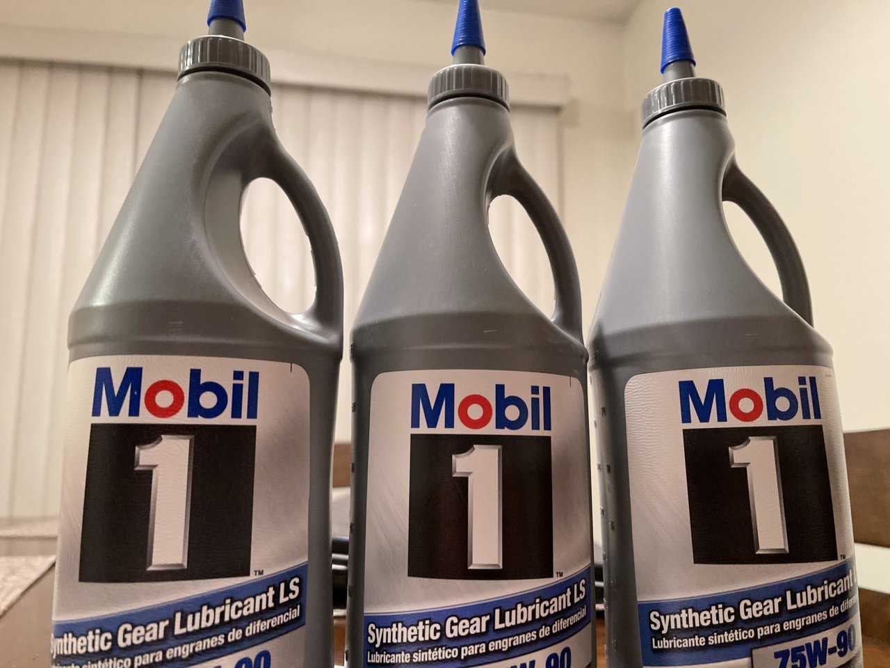

    Got my fluid finallly! 3 quarts is enough right?
    i read somewheres someone said 3.12 or some crap but i’m not sure if that’s accurate as this how to says get 3 quarts.

    Going to change my rear diff oil this week, am I reading right that if I use Royal Purple I'll need 3 qts, and I have a TRD off-road so no LSD additive is needed?

    You can confirm by consulting the Owner's Manual............
    Quantity and Lube type (with or w/o LSD)

    i changed my diff fluid on Friday night. Buy 4 quarts. I needed about a little over 3.5.
    no lsd additive needed only sports need those.

    Only sports '08 and earlier need the additive. Newer ones don't need it.
