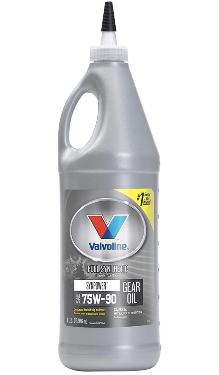

    Hey everyone, has anyone used Valvoline 75-w90 full synthetic for the f/r diff or transfer case? It says it has 4oz of LSD fluid already mixed in. Mine is a 2011 TRD sport 4x4 w/ just over 100k. Don’t think it’s ever been changed, but the truck hasn’t been used heavily.
    NAAC3TACO likes this.
  13. Aug 7, 2021 at 3:21 AM
    #2713
    NAAC3TACO
    NAAC3TACO Middle aged member
    Aug 5, 2008
    #8350
    8,059
    Just east of crazy, NV
    2014 SR5 DCLB 4x4
    Color matched door handles, Weathertech floor liners, bed mat, Durafit seat covers, tailgate clamp, 2016 TRD Sport 17" wheels with Yokohama Geolander AT tires , Toyota exhaust tip, Toyota/Yakima bike rail mount, Toyota wheel locks, Toyota hitch cover, Redline hood struts, unifilter on air pump.
    That’s exactly what I used. No issues.

    Thanks for the speedy reply! Good to know :)

    My pre-runner 2012 2wd has the electronic braking for slip control.
    Regular 75w90 gear oil should be fine right?
    I can’t imagine it has a requirement for LSD additive…
  18. Sep 13, 2021 at 7:36 PM
    #2718
    NAAC3TACO
    Aug 5, 2008
    #8350
    8,059
    2014 SR5 DCLB 4x4
    75w90 will work fine. You don’t need additive.
