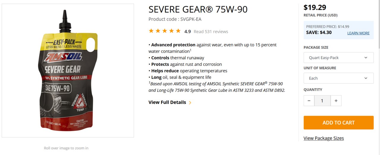

    I used Amsoil Severe Gear 75W90 and have had zero issues. I like their packs which make it easy to pour.

    I heard a lot of guys liking the severe gear. The squeeze packs seem easier to use too. So with those you don’t need a pump for any of the diffs or transfer case plenty of room to just squeeze them in?

    No you don't need any pump with the Amsoil packs. I also replaced trans fluid, I think you could do that without a pump but I had a transmission pump with my fluid in it that I used.
    I actually got setup as an Amsoil dealer recently, had been using their products and really liked the good results we were getting, especially with ATF.
    Looks like the Severe Gear 75w90 is around $20qt retail depending if you buy a case or individual. https://www.amsoil.com/p/severe-gear-75w-90-svg/?code=SVGPK-CA

    Sounds convenient, but packs are a bit steep. I wonder if it’s because they are convenient and easy to put in or is the severe gear really good stuff?

    There regular quart bottles are same price, you pay a premium for a premium oil. :) If you create an account on Amsoil you can get Preferred customer pricing which is $15 per qt.

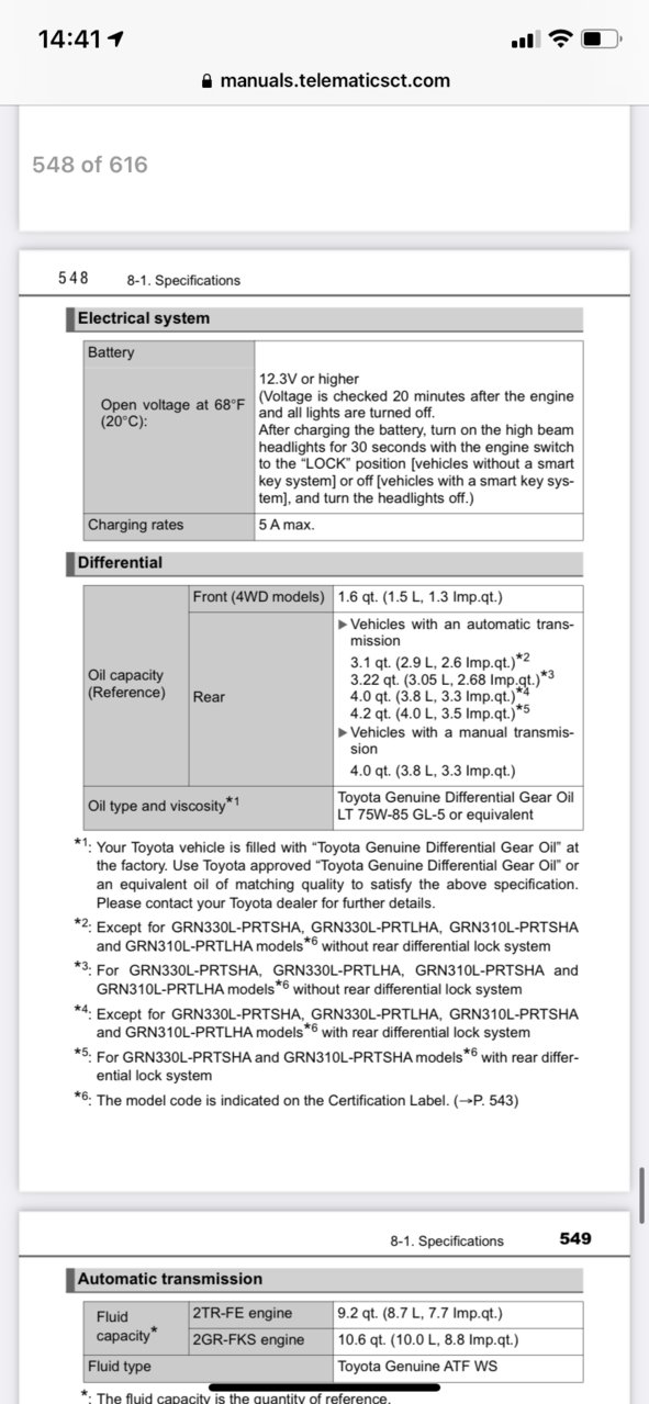

    I am fairly new to working on my vehicle and am having trouble figuring out if my truck will need an additive for the rear diff. I have a 2022 Toyota Tacoma TRD off road 4x4 with rear locker.
    I’m planning to buy 6qts of redline 75w-85 fully synthetic oil to change the front and rear diff fluid. In the future what other options do I have?
    I am fairly certain my truck will take 4.2 qts in the rear unless I’ve misread my manual. Is the .2 the additive?
    I saw the note on the first post that mentioned 2009 or later/ trd off road won’t need an additive but have also heard conflicting information. Would the manual state that I would need an additive if I do? Thanks in advance
